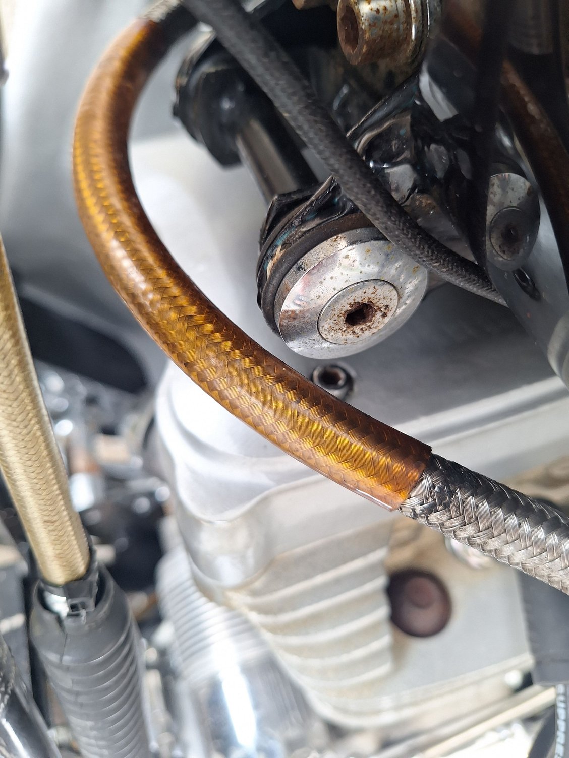

I'm trying to remove my Titan Roadrunner's dash because my digital speedo/tach power went out. I need to raise the tank but have never done this before & need help. Is it just the front tank bolt/axle?

Can you possibly get something under the head of the bolt to give it upward pressure while loosening the bolt? Maybe the piece that it's connect to is spinning.

I think I got it figured somewhat figured out. I wonder if my Roadrunner is missing something. Can't see dash removal THIS difficult from the factory.

Its a loose connection. Went for a ride yesterday, hit a bump & speeding/tach started working again. Loose connection. Only anchor I see is the axle bolt near the triple tree. Can't believe this is the only retention point on the tank?
