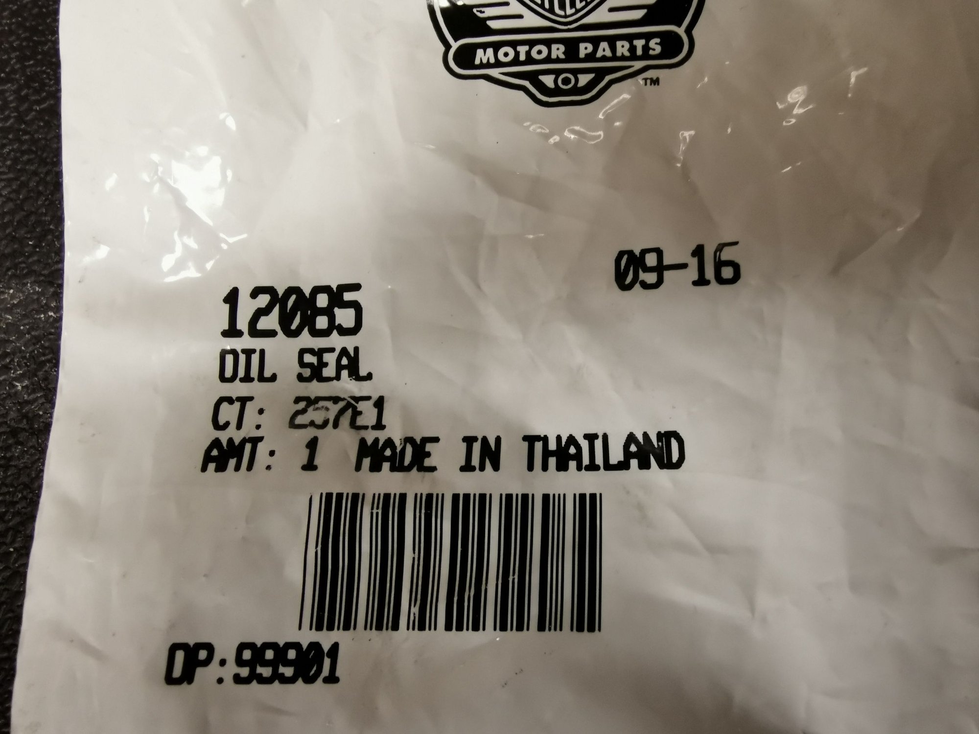

It is used on other Harley Davidson also and have this part no 12085
