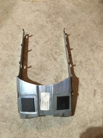

Took this off the bike, do I really need to add it back? What even is it?

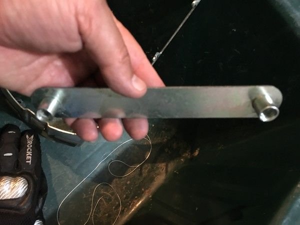

Any trick to placing these? Seems like I cannot fit my hands between the tire and fender and they have to go in exactly to work:

First picture is a splash guard
Second, jack up your bike and let the tire hang. That should give you some clearance.
And yes, ALWAYS use at least Blue Loctite.
