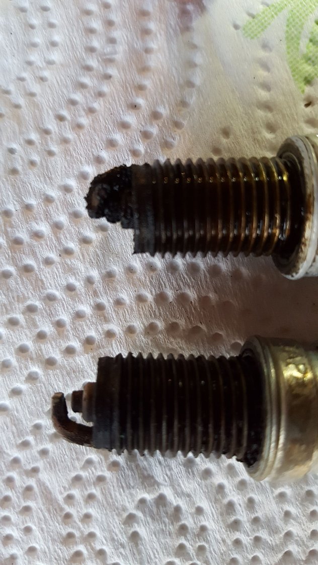

I drained the tanks to rule out bad gas and put fresh gas in. Tried to run it and it would barely run.
So I pulled the plugs. The front plug was Fowled badly. The rear plug was clean but appeared to be a little on the lean side.
I replaced both plugs and she runs like she's supposed too.
I'm going to monitor closely as I'm not sure if it was bad gas that was causing the issue or there's something else going on.
Again, thank you all for you input!!!

Pics of the plugs

Originally Posted by Fishhog
Pics of the plugs
Yep, the top plug looks fouled. How many miles on the plugs?

Mileage is unknown as they were in the bike when I bought it.
Well, at least you found the problem....now go enjoy your bike!
