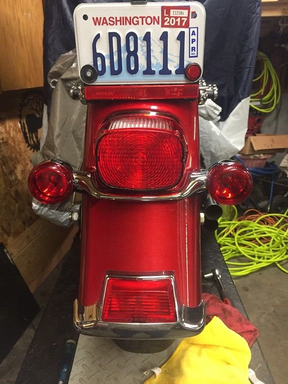

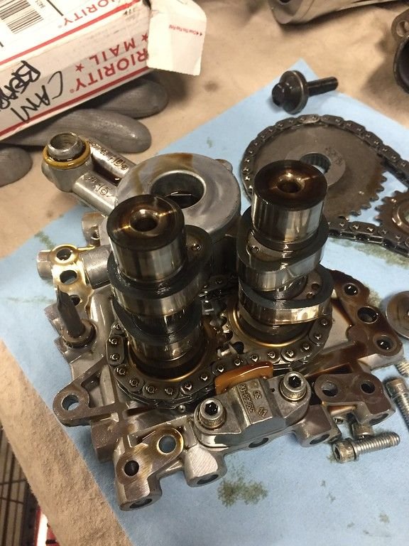

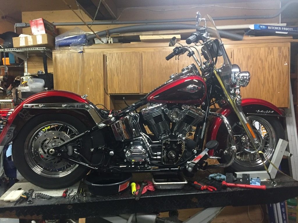

Part way finished with some of my wintertime mods. I have been collecting things for the last year and a half for this. So far, I have installed the Andrews 57H cams, bearings and SE Tapered Adjustable Pushrods, Softail Deluxe style rear turn signal bar, and rear HD Smooth Profile Laced Tubless wheel with Whitewall tire. Think I scored a pretty good deal on the wheels. They were takeoffs from a 2013 Heritage with under 5k on them. Picked up the set for $200. I did have to pull the bearings and install the ABS bearings, but no big deal.
Still have to open the primary to install the Game Changer gearing and the Barrett clutch spring. Also pulling the forks and installing the Progressive Monotubes, chrome lowers and the front smoothie.
Should feel like a different bike after all this, and liking the way the wheels and tires are looking.
