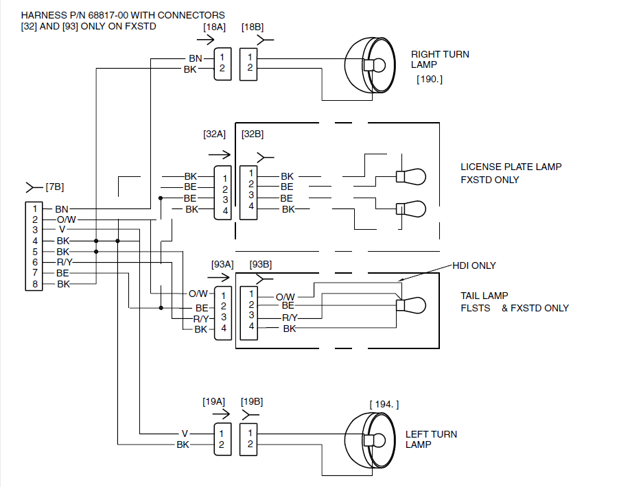

Have a 2001 Deuce that i am making custom rear fender and lights, and would like to use original 8 pin Connector under seat to hook it up to the bike....is there a wiring diagram out here on this Connector?

You see that´s the problem......don´t have that :-p

Thanks a bunch. ...exactly what I was looking for 😊
