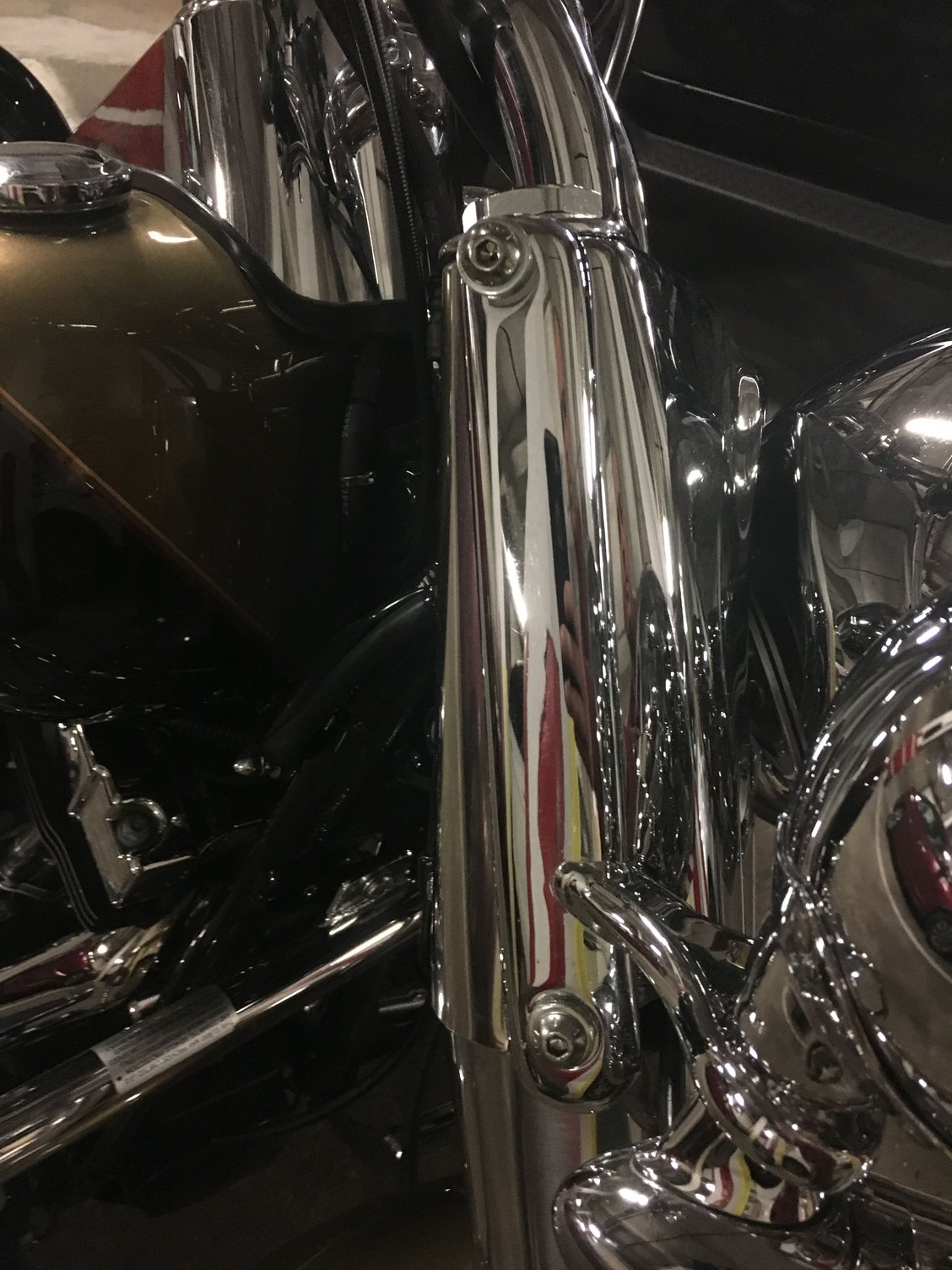

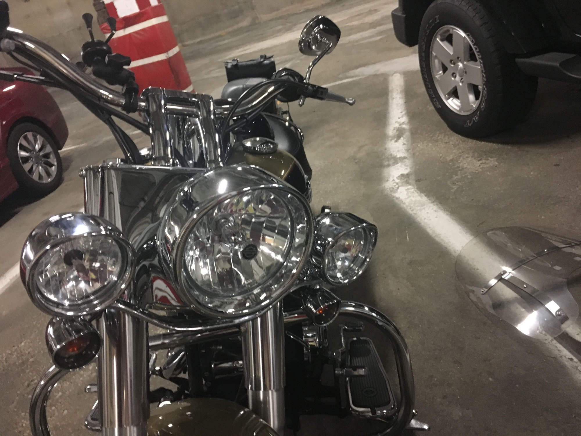

Guys my buddy just gave me a quick detach windscreen. it came off a fatboy. What bolts/hardware do I need to install this thing?? I've tried looking online for the bolts that go into the sides of the forks with the rubber grommets but no luck. Any help would be appreciated.

Looks like you probably need: 57184-05 KIT, HARDWARE, W/S MOUNTING/DOCKING
It may depend on exactly which W/S you have, but take a look at:
https://serviceinfo.harley-davidson....ocument/114701

The regular W/S shows a different docking hardware kit.
91800025 - KIT-HARDWARE WSHLD MTG
https://serviceinfo.harley-davidson....ocument/113680
That one appears to be less expensive.
Did the Fat Boy have passing lamps?

I believe it did but im not sure. He sold it a while ago.

Those side plates on the windshield look like the type that are meant to fit without the passing lamp bracket.
