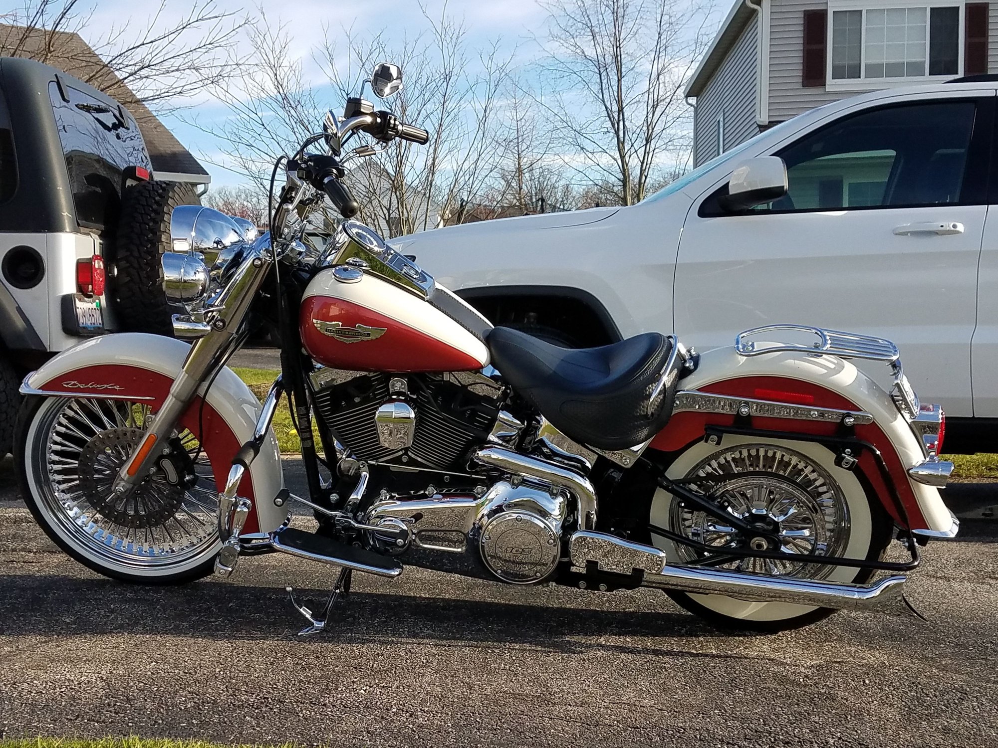

Just picked my bike up from the shop last Thursday, and finally had some time to put some mile in this thing. I had a Fuel moto 107 kit with woods 555 cams installed and dyno tuned, and the results are pretty impressive. My bike went to the shop with a stage one and had 67hp/ 87 Lb. ft of torque. I thought that the true duals would suck the life out of the low end torque, but it made 93 horse/ 113 lb.ft. of torque. The duals actually killed horsepower more than torque.
At around 2,000 rpm's it is already making 100 pounds of torque and continues to pull hard through the entire rpm range. I also changed to a 70 tooth sprocket in the rear, so that made a difference as well. Overall, I am pretty happy with the way it runs and it sounds pretty awesome as well. Now it is time to ride the hell out of this thing!!

Beautiful bike but I see something you have to change...the 103 derby cover.!!!
I bet it almost feels like a new bike with all that power. Have a blast and stay safe.

I also did the fuel moto 107 with woods 555 cams and heads on my deluxe. Bike runs like a raped ape! You will be very happy with it! Good luck. Beautiful bike by the way. Dennis
