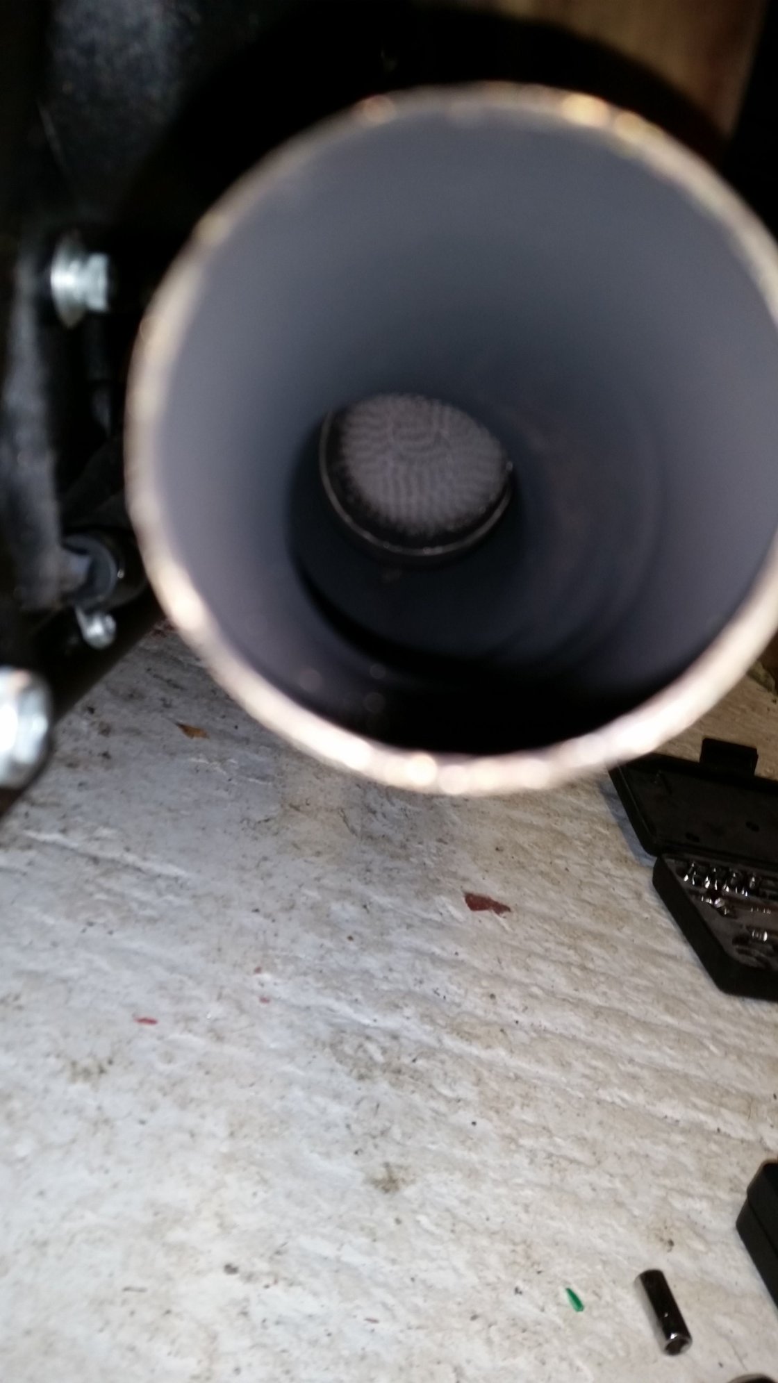

One of the cats. before I removed them.
The Cats are in the headers and not the mufflers for the fxfbs, 100% guarantee..
How did you get the cats out?

Saw them in half at the weld between the balance tube and the cat.. drill like an idiot with a couple of 32mm wood drills, clean it all up (wear a protective mask and do this outdoors!).. then ask the finest artisan welder in the country to weld them back together..!
while you’re at it.. 30mm core drill the standard silencers and get them satin black coated..
I like the standard look, and now I have the free flowing 2:1:2 that Harley envisaged.. power cam and tune on Wednesday.. shame it’s winter and the roads are like glass!
