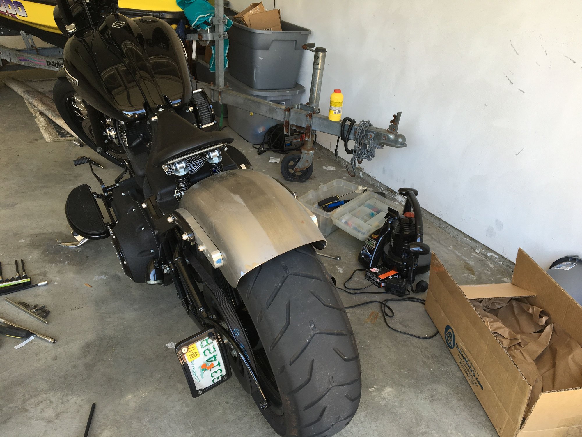

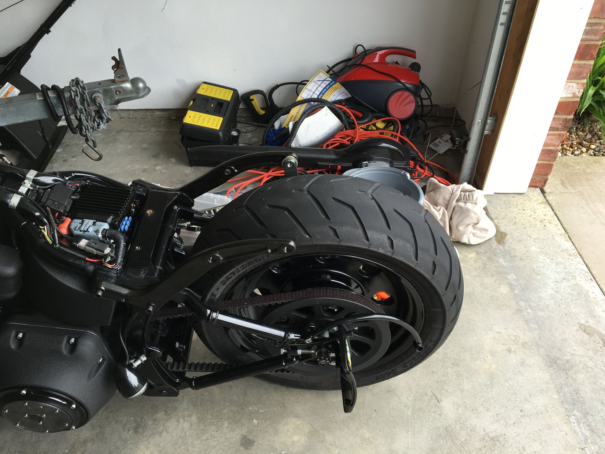

Well when I was considering to go full Bobber with my Slim like this (pic 1), I did some sizing (cut a wood block to fit) with a Shorai battery model # LFX14A4-BS12. It would all fit in the battery box with room to spare. But I have decided to keep my current config (pic 2)

Also the picture you have posted looks like the guy went cheap and used a purse of leather to cover the battery which is fine but he used white zip ties
