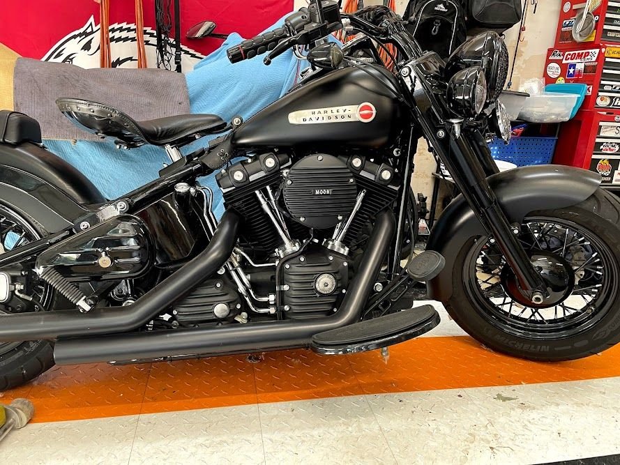

Hello, a great big HOWDY from snowy France ! May I ask you a question ? On the first two pics, your front fork seems to have a wider rake than stock one. Is that a optical illusion or is there an Arlen Ness Raked Triple Tee involved ? Merci beaucoup for your answer !

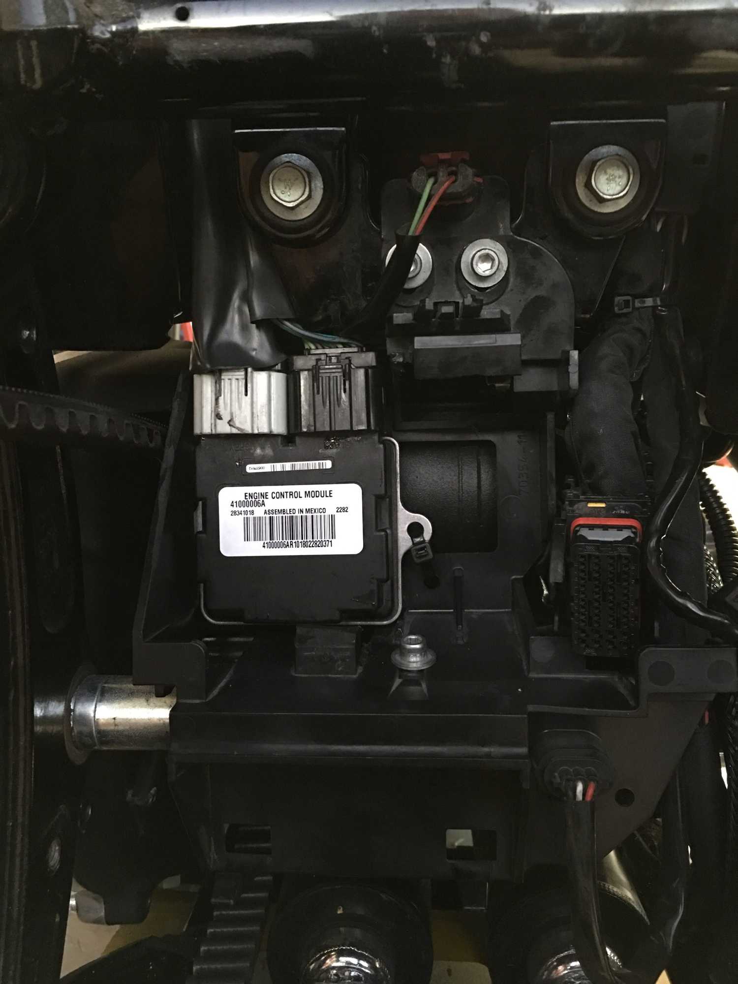

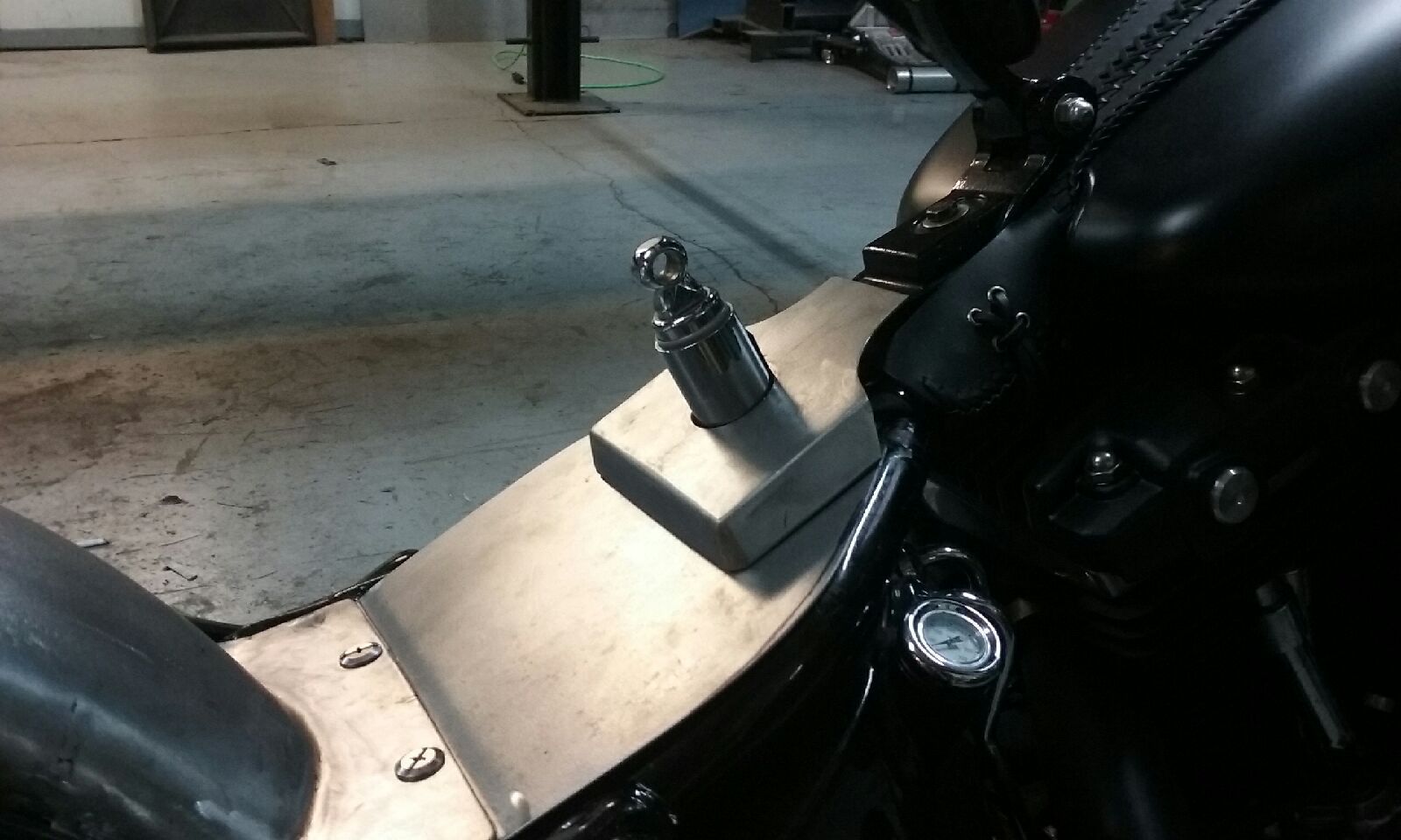

As mentioned above, you can stash the ECU in the compartment forward of the 'rock guard'
with the BCM. If you also run a small lithium battery (I use EarthX LiFePO4) it will allow
you to have a true 'flat' pan cover. Here are a few pics:
hth,
T.
