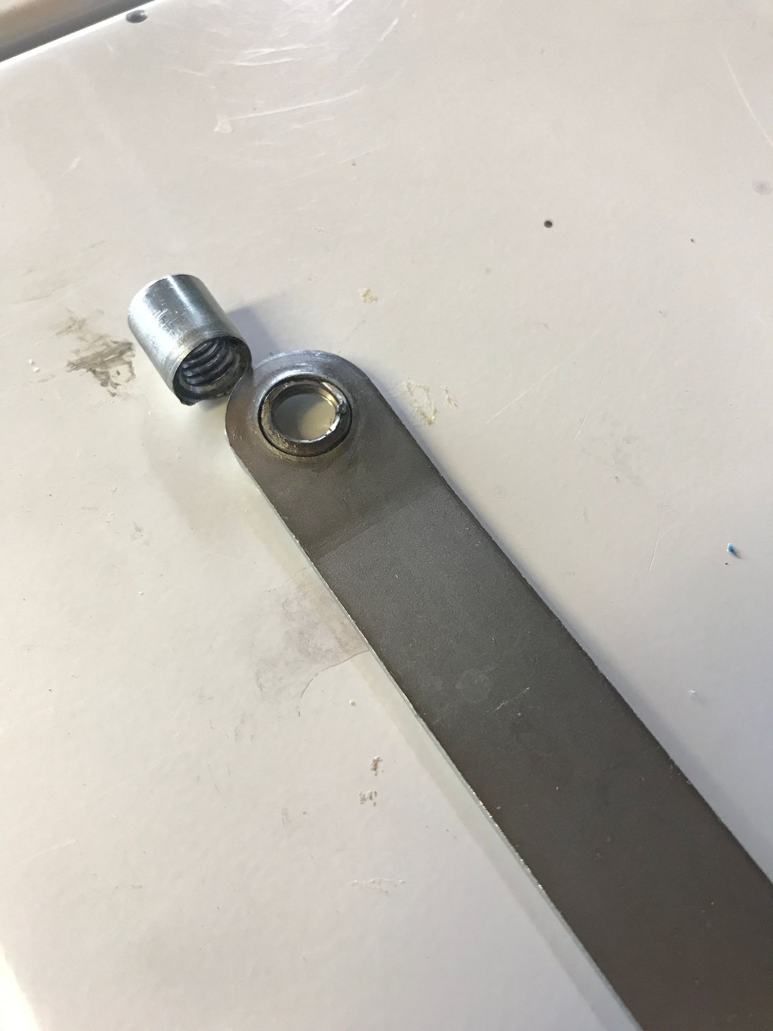

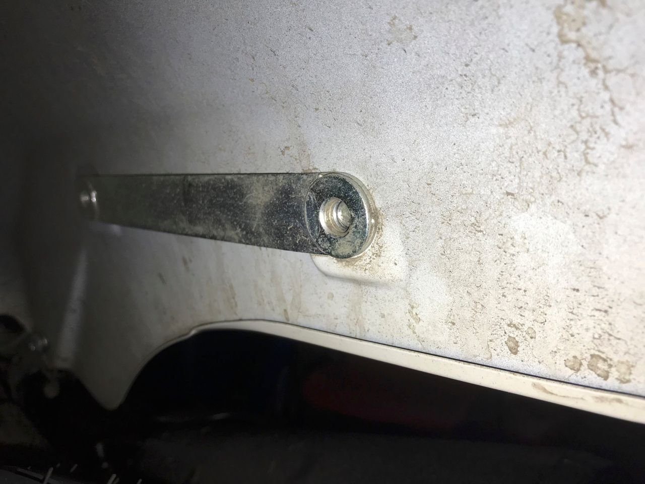

I will take a pic of the service manual and my bike tonight but had mine apart last night and there was def a nutplate on the fender strap. U don’t want those bolts longer they would be sticking into the fender well.

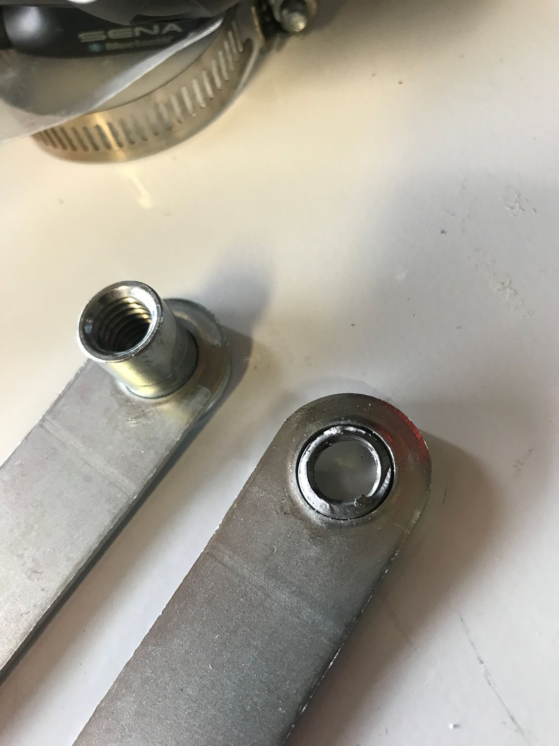

Yeah - definitely what Gar said!
My fender straps had threaded bushings welded to them that fit into the holes in the fender and the fender struts themselves. So when you mount the fender, you can push the strap bushes in place and it holds the fender in place while you do up the bolts. I thought is was actually pretty good design.
Looks like your bolts are the right length, but your fender straps are missing the threaded bushings. Very strange.
Not the best photo, but you can see that the bolt doesn't protrude out as far as the metal fender strap itself. It's screwed into the threaded bush behind it. You can't see it but is about 3/8" deep or so and is on the other side of the strap.

Found the issue!

Looks like the guy that assembled the bike forgot how to use a torque wrench. I also would like to see that exhaust and a possible sound bite.
