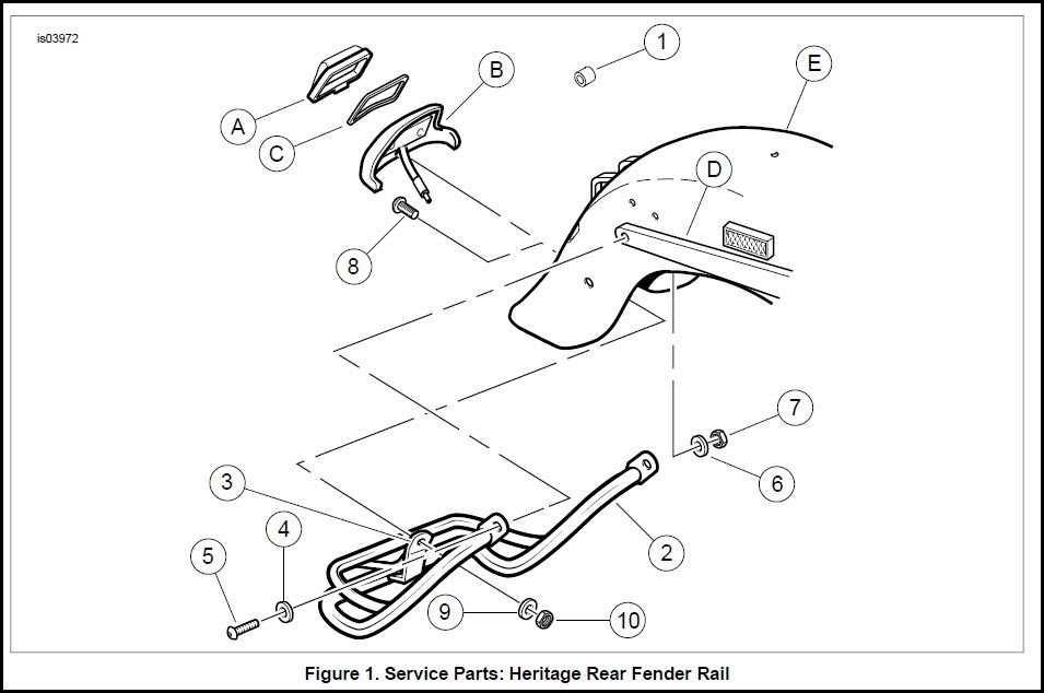

I read your post and don't recall drilling my fender so I decided to look at my installation and the instructions.
The instructions certainly state to drill the fender but I can't see the new hole in the diagram that's in the instructions.
There's only the three connection points and all of those holes are existing.
I'm not sure what the purpose of the 2 new holes are.

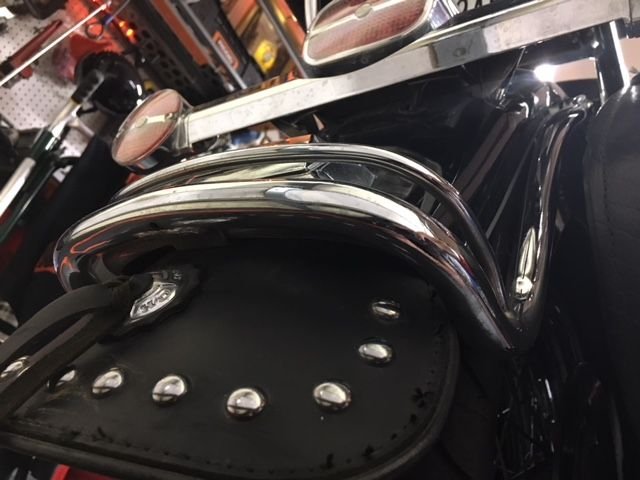

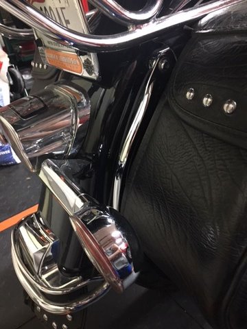

Anyway Here's the pictures of my installed rail.
As you can see there's no new holes.
If I recall correctly the installation was straight forward and easy.

I didn't drill a new hole. Loosened the fender support cover (D in Bluraven's pic.) enough to slide the nut and washer into/behind it. I had read on here someone doing it that way. Little tight but it worked out fine.
