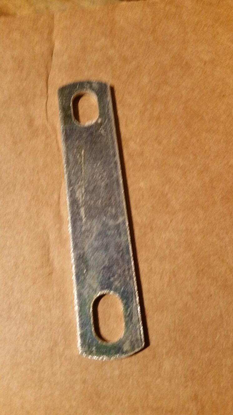

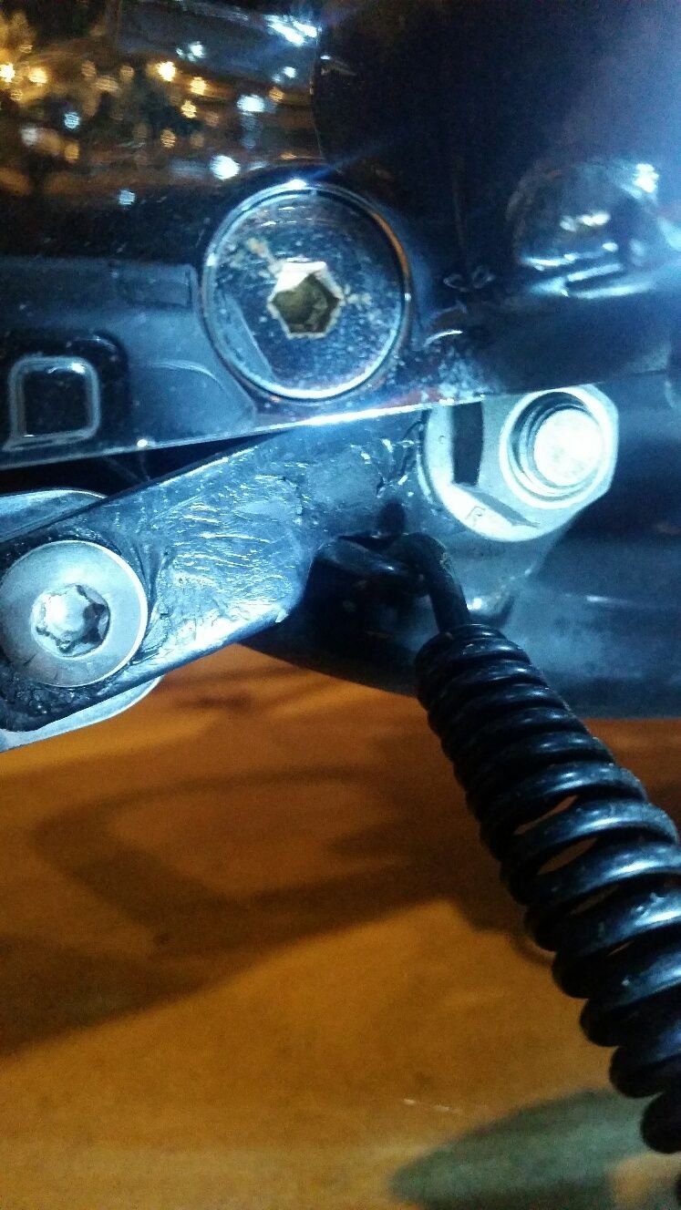

I had to fabricate extensions to mount the crash bar to when I put forwards on! wasn't hard, someone probably makes mounts just for such but at the time I couldn't find any! good luck.

Let me see what I can do, it was really in expensive - the hard part for my bike was the kickstand spring has a little bump out or extrusion from the weldment so I had to notch around that. I painted the extensions black - so let me see if I can get a good pic of both sides for ya.

This is just a piece of flat rod drilled at both ends
I took out the front engine mount bolt & slid it through the flat stock to get an idea of what I would need to do & get the length for where the Crash bar would mount - a sharpie marker gave me the profile & then I just "trial & error" it until it fit, I just painted the nickel coated flat bar black when done to blend in. I used the motor mount bolt & lock tite to make the structure solid - hope this helped.
less than 5 bucks & maybe a half hour of your time! good luck
hope this helps

Awesome this is really helpful. How is clearance between footrestsand controls? All good?

I have the Mustache crash bar with forwards attached by using what you see here, all clearances are good, the only thing with the mustache crashes is the shifter - I had to mess with it to get it so my foot had enough room on the down shift between the top of the crash & shift peg. if you have the standard crash bars you`ll be fine.
