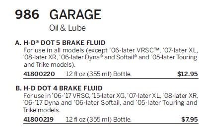

Not to be a smart *** but what type brake fluid is stamped on your reservoir cover? DOT5 might be the wrong type.
Old May 20, 2018 | 10:05 PM
multihdrdr's Avatar
multihdrdr
Joined: Oct 2011
Posts: 11,176
Likes: 2,488
From: Nor Cal
Here...Save this somewhere you can reference it in the future
2018 Listing
