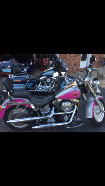

Heres the 92, its a breast cancer awareness anniversary, i dont mind the color however im im gonna store these fenders and tank and also get the 6 gal tank and undecided on fenders, and paint her black, go for an old school look...
