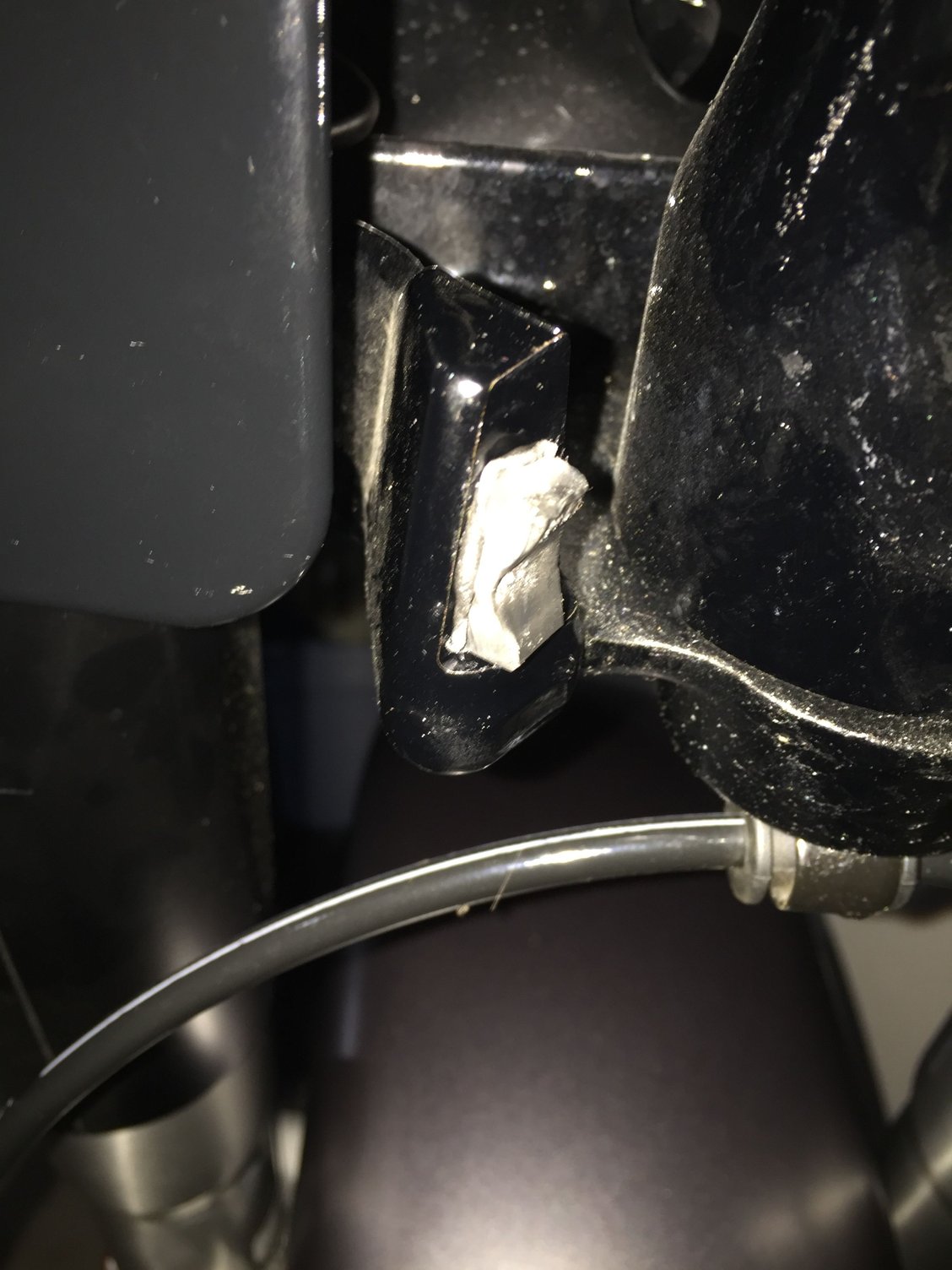

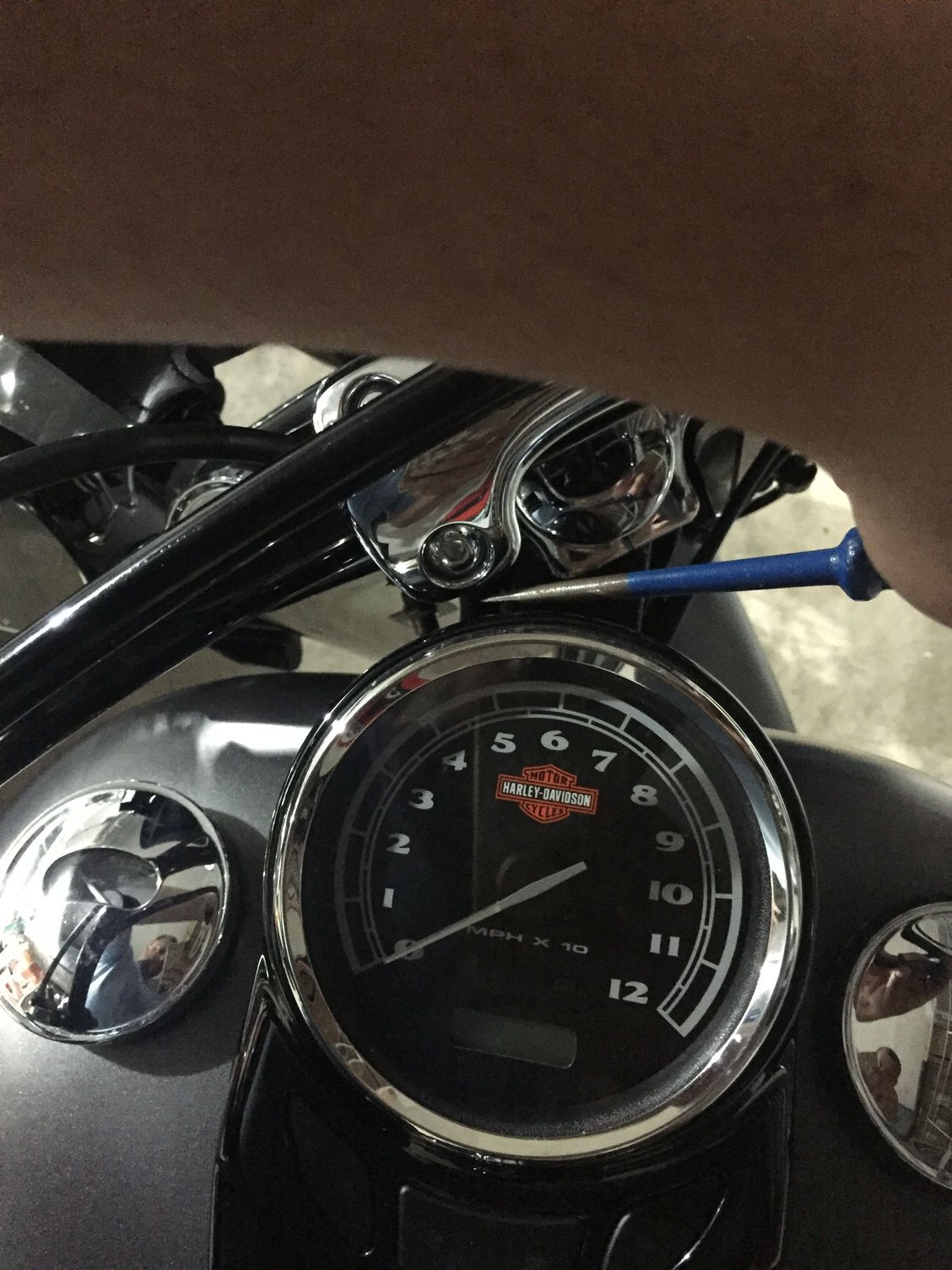

Hi Guys
I installed pullback risers from Deluxe model on my 2014 Slim. I have the issue with clearance between riser and speedo housing. I made it work by installing spacer on lower tripple tree but something is not right. Without spacer i could barely squeeze sheet of paper between riser and speedo. What is wrong with my bike?
I have seen other Slim with exactly same riser at dealership and there was plenty of clearance which I cant do on my bike. Today I even replaced riser bushings but no change. I also tighten stem screw as I expected maybe it was loose on bearing from feont end but all was nice and tight and bike has only 1500 miles on it so it is practically new from factory.
Not sure what I am doing wrong or why will same model with exactly same components has proper space while mine has not.
Pictures below.

Looks like you answered your own question. Your bumper stops are crushed.
I had the same issue, except mine actually would hit. I had to go with straight risers.

What you see is actually spacer I put there so riser dont hit the speedo. Originally there was nothing there. I added this piece of plastic.

Looks like someone else reported same issue - clearance that can fir only ctedit card. In my case this is barely sheet of paper. Not sure whats the deal as some people have no issue. Wonder if upper tripple tree design changed or something else is the cause?????
