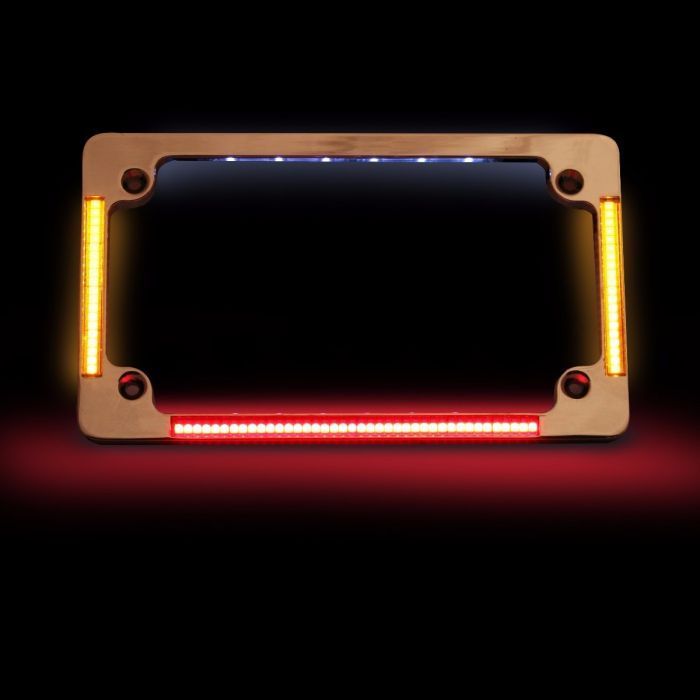

We have an integrated taillight that has the turn signals built into the center brake/running light. I've attached a video of it. It's a plug-and-play replacement for the stock taillight on the 2010 Fat Boy Lo.
Another option would be one of our Quad Plate Frames. We recommend they be used as auxiliary lighting rather than as a total replacement for your stock lights, but they do contain a running/brake light and turn signals. I've put a photo below.
With both of these products, as F150HD suggested, you will need a load equalizer or Standard Smart Signal Stabilizer to prevent your LEDs from rapid-flashing.
