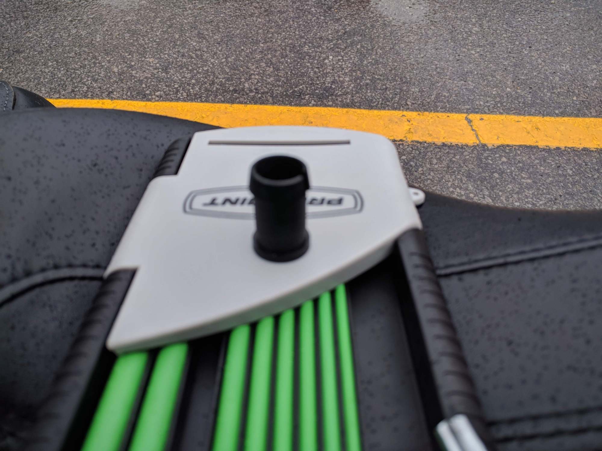

OK, I figured it out on my own. As stated above, you CANNOT purchase the slider pin bushing. How the factory part vibrated or broke off is unfathomable!!
So, I had one made for me....for a lot less than a new caliper. This bushing Is much better in design and stronger than the factory part. Made from high strength plastic, the inboard side of the bushing has an arrow like shape with a cut through part of it. When inserted completely through the bushing, it expands and stays locked. The outboard side has a lip around the perimeter to stay locked. It works awesome!
See attached.

Excellent work-around!
