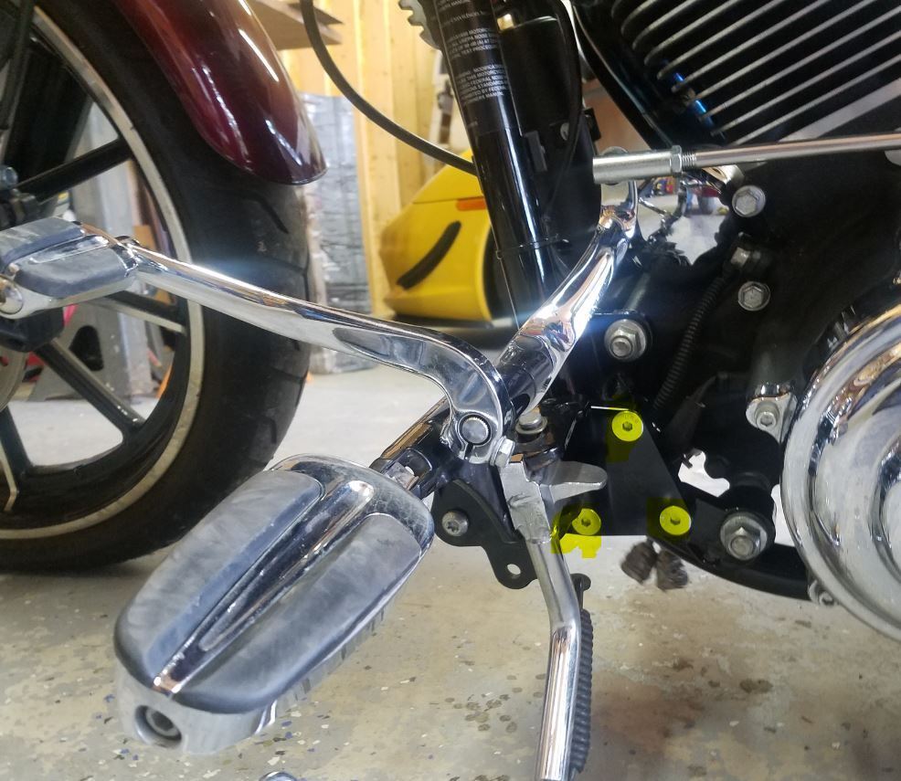

I installed the Alen ness extensions this weekend. They bolt right into the stock peg mounts in yellow below. I consider this a mild PIA installation only because I needed to remove the rear wheel. In my book anytime that comes off immediately bumps the job to mild PIA and above. Anyway, fairly straight forward installation.
Product quality is good, the shift rod is as ugly as the stock and it uses the stock ends.
As one poster mentioned, there is no increase in ground clearance at all. Everything still scrapes just like stock. For me the ride is more comfortable (6'4") so no complaints. I think it's a good alternative to the HD parts at 1/2 the cost.

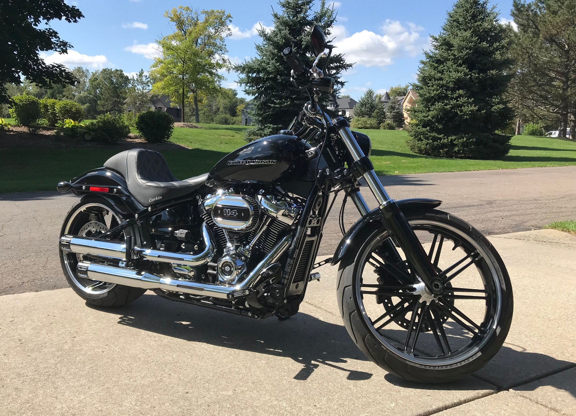

2018 Breakout 114
These are my big&tall category mods done with HD parts:
- 3" forward controls
- tall boy seat
- 16" apes
- screamin' eagle stage II, torque
- sometimes add 19" wind splitter super sport windshield
awesome bags are from ends cuoio (I didn't want to extend the tail lights & license plate)
I chose Breakout because it looked best suited to adapting to a tall rider with parts available from the factory. I'm comfortable and I like it.
