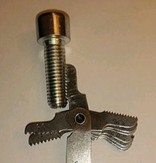

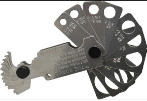

The "no guess method" involves a bolt sizer/thread pitch gauge.
