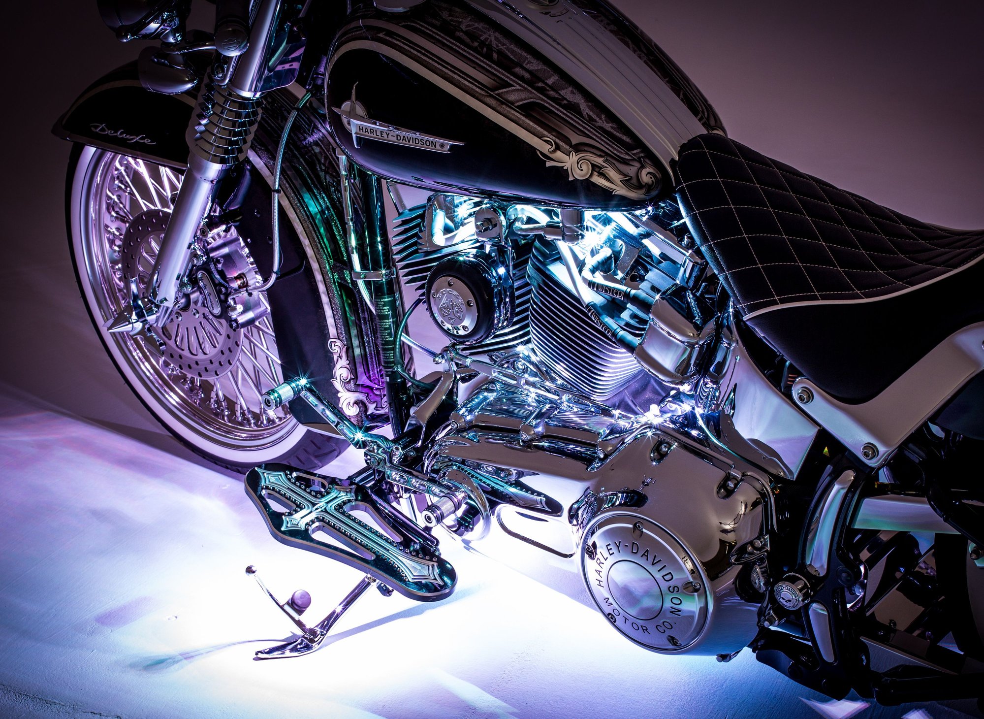

XKglow

Originally Posted by S.D.M.F
XKglow
First of all your bike is amazing my friend! I love the paint job. Which XKGlow kit did you use? I see they have 6 pod to 10 pod. Where did you mount your front wheel lights?
It started out as the basic 10 pod kit...and then it grew. It is now a combination of pods and various length strips.
Currently the mounting position are:
- Front fender: 3 pods underneath (all on the left side with wiring running with brake cable)
- Voltage regulator: 1 small strip inside it
- Frame rails: 2 long strips underneath mounted more inwards so they dont get crushed when on a lift
- Horn: 1 pod inside cover
- Air intake: 1 pod underneath
- Fuel tank: 4 pods underneath (2 each side)
- Footboard: 1 pod under each
- Oil tank: 1 pod underneath towards the front
- Rear fender: 4 pods underneath (2 each side)
I think thats all of them. All wiring hidden.
