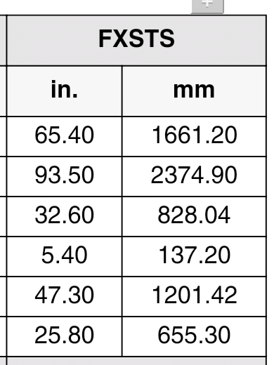

Owners Manual shows a saddle height of 25.80"

Where does it specify to measure “saddle height”?

The Owners Manual doesn't specifically mention where the saddle height measurement is taken from, but typically it's the lowest point of the saddle. Keep in mind the numbers in the OM represent the original equipment saddle.
