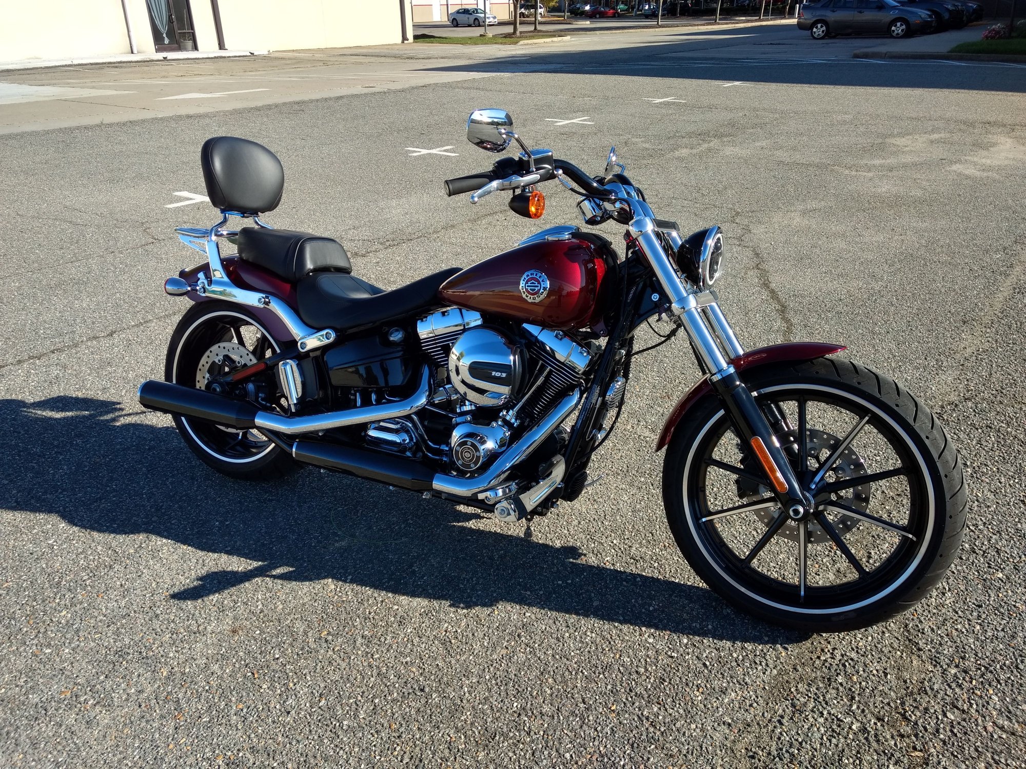

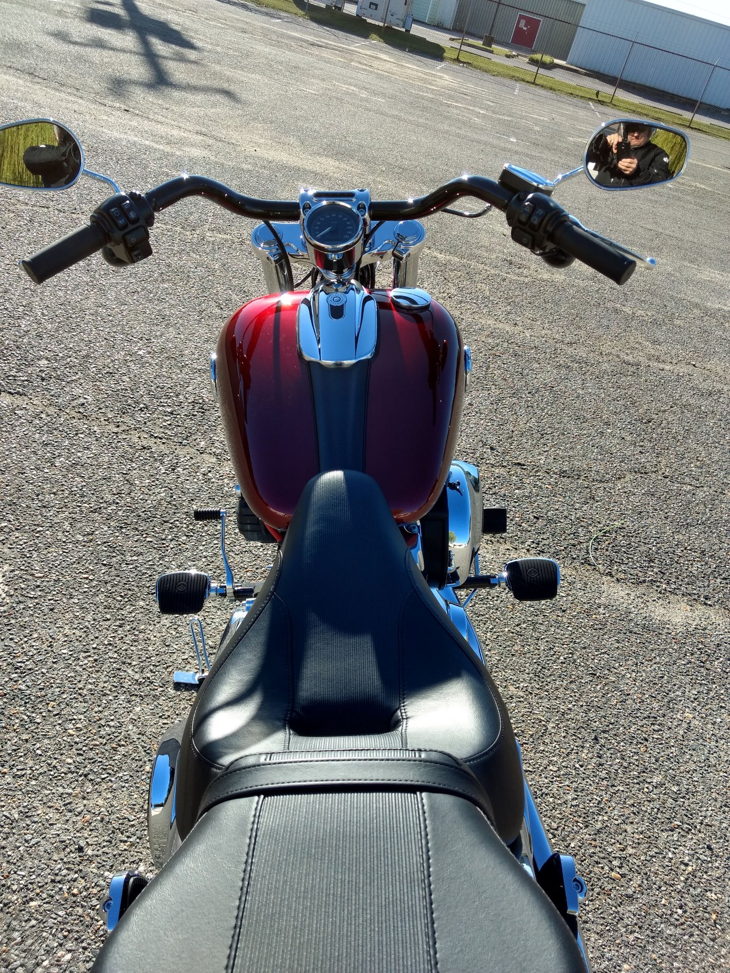

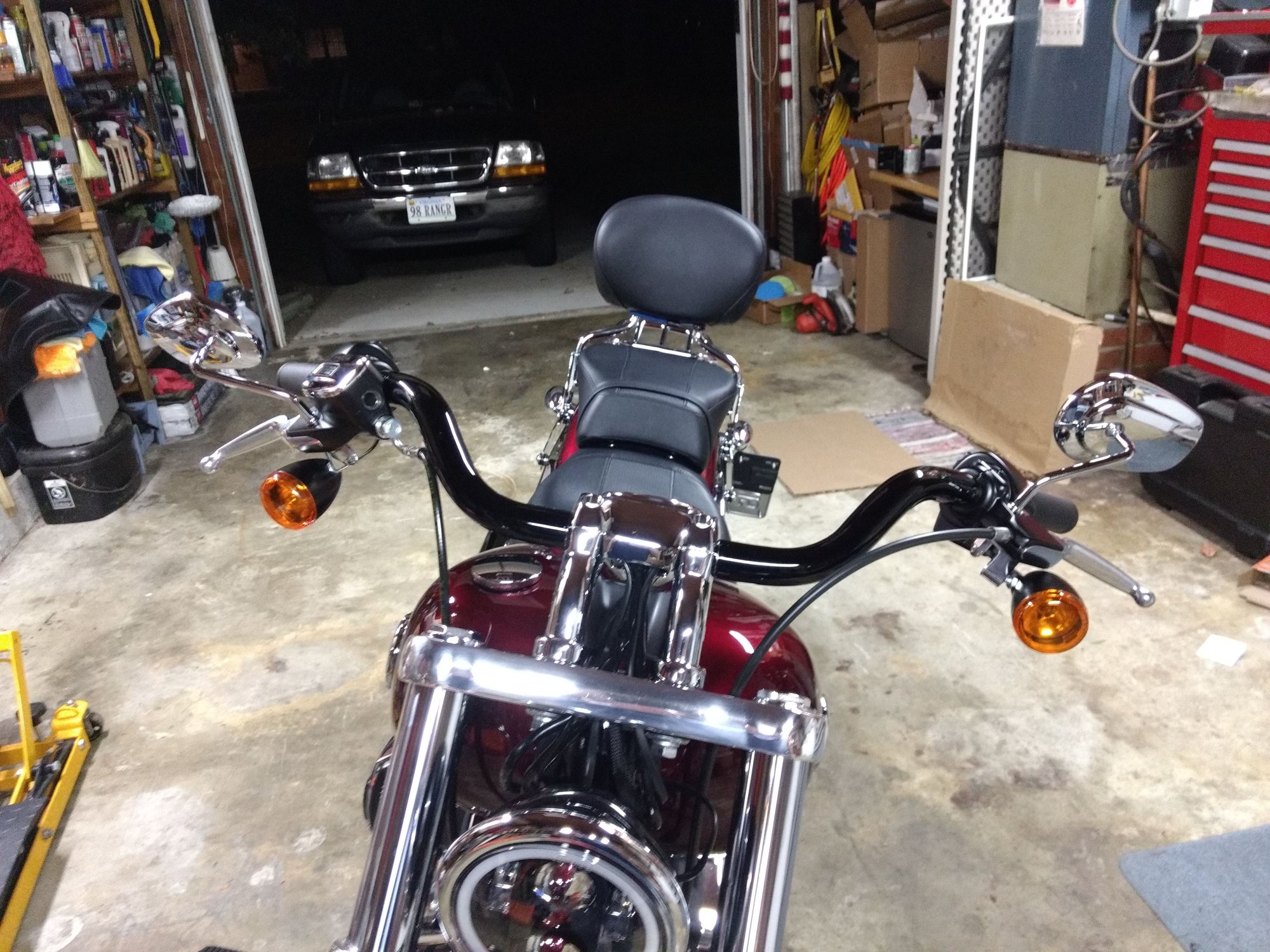

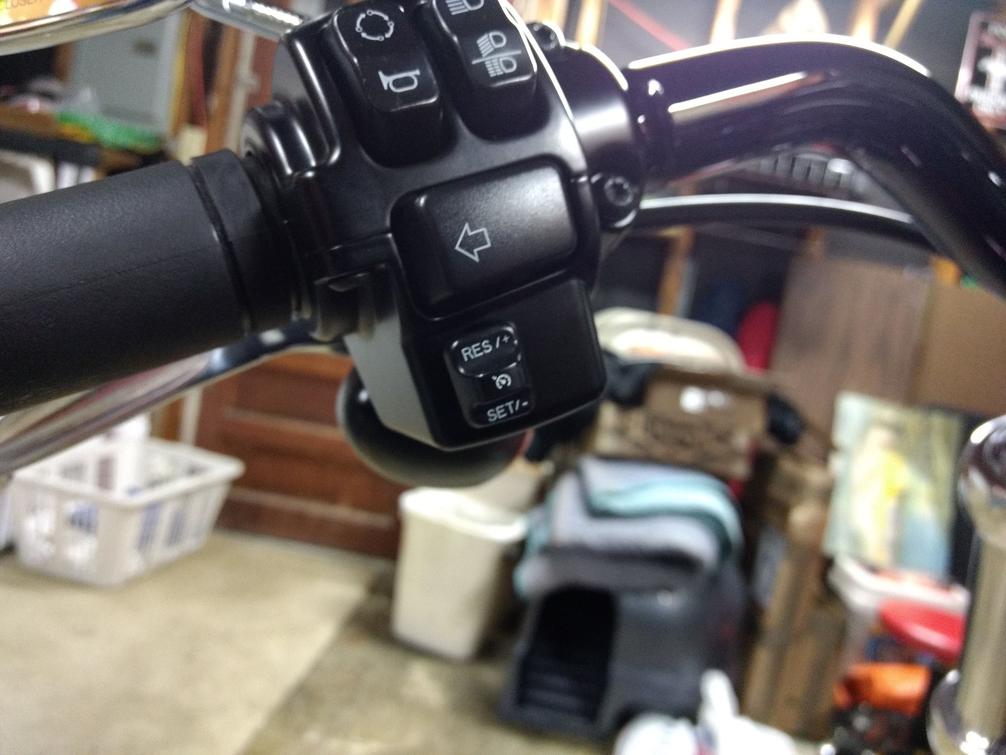

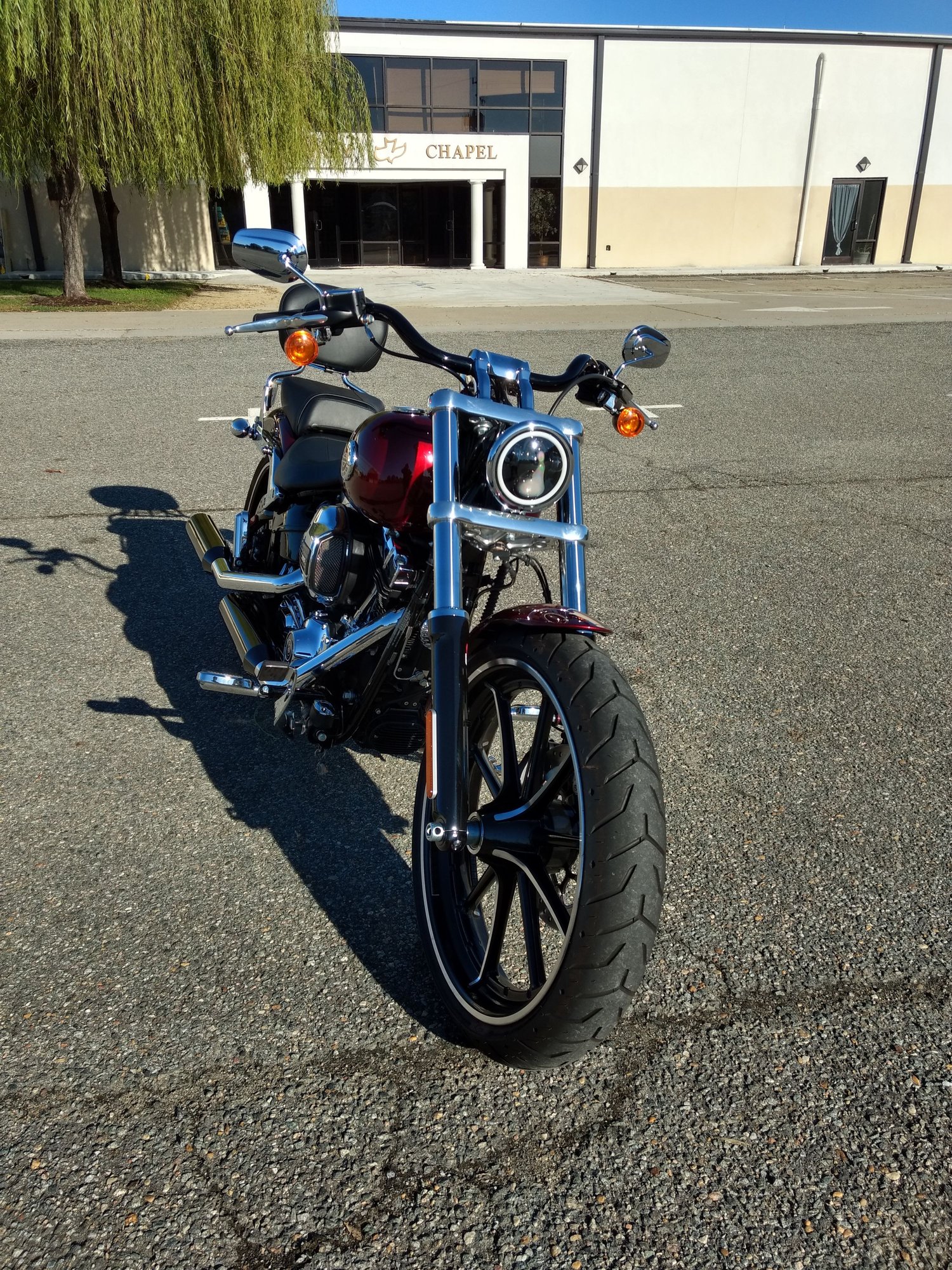

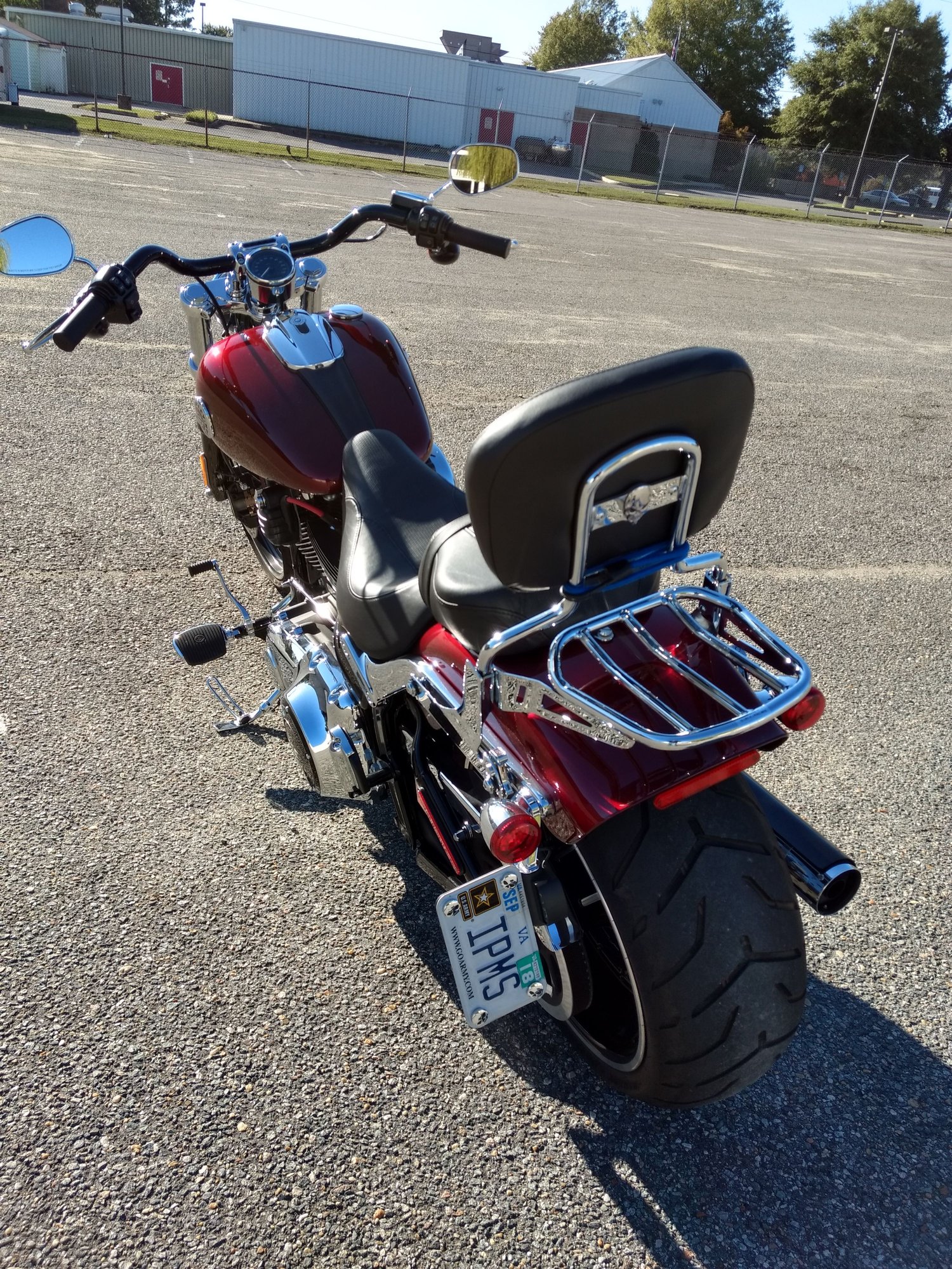

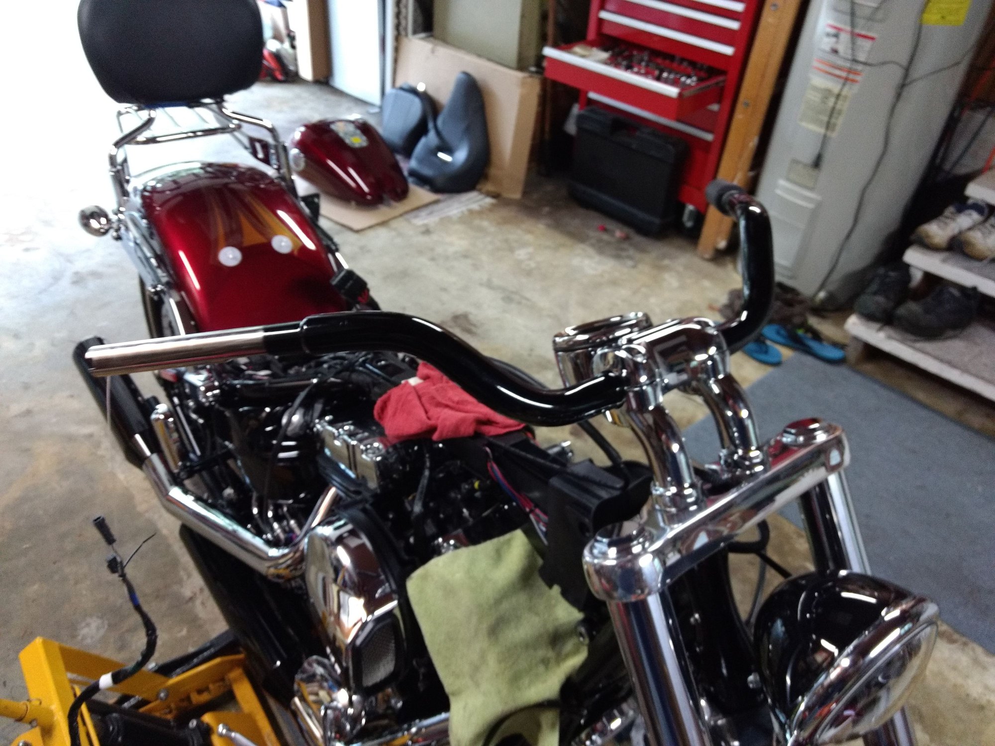

I installed a set of new take off black bars from a 2017 Fat boy S. I installed cruise control and new grips also You will need a longer upper brake line if you have ABS. I am 5'-4" and the bars are a perfect fit for me!
