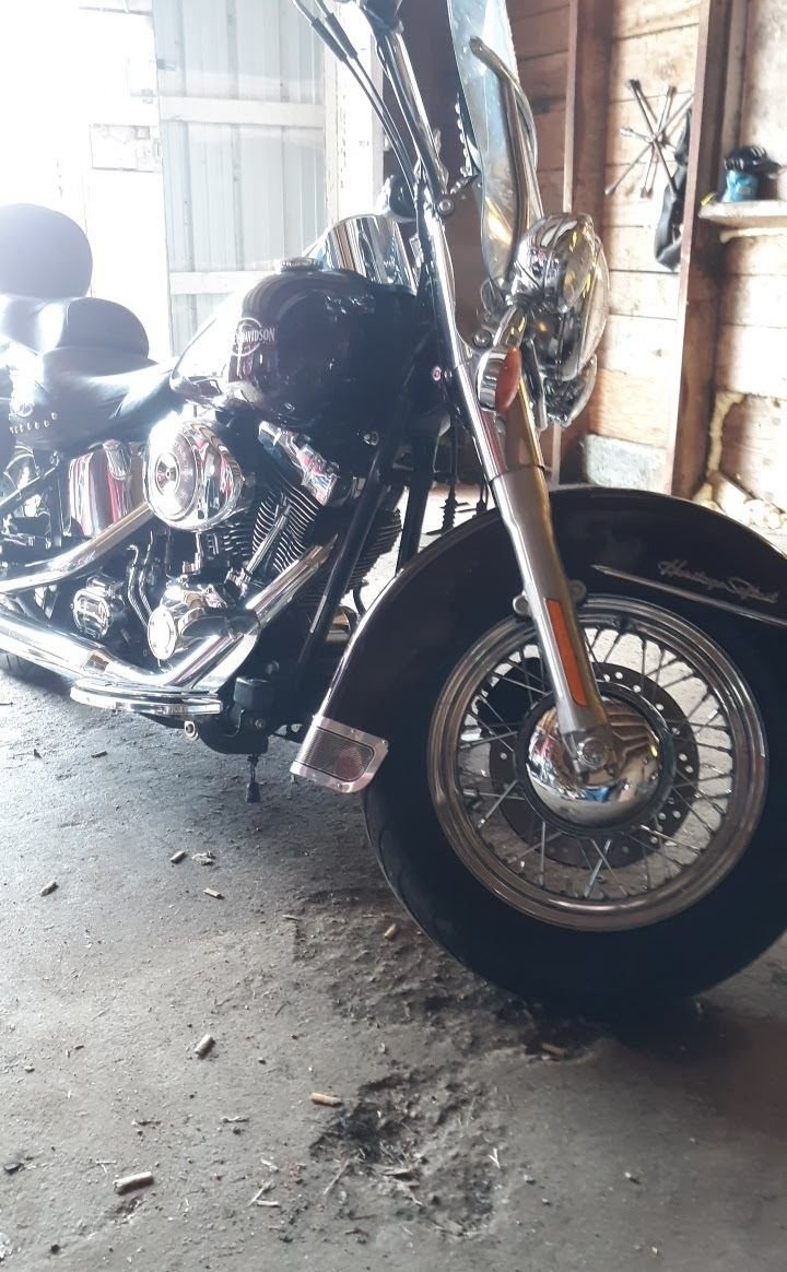

Hey guys got an 05 flstci love the bike incredible ride however I'm a bit low on power with my wife and I on it was just wondering what upgrades have been done to this motor that actually work good without costing an arm and leg or having to be worked on constantly... looking into cams 509 510 585 hydraulic tensioners not sure what intake would work good not a big fan of the SE products I prefer s&s and just would like to hear from tried n true installs.

Old Jul 18, 2019 | 09:42 AM
