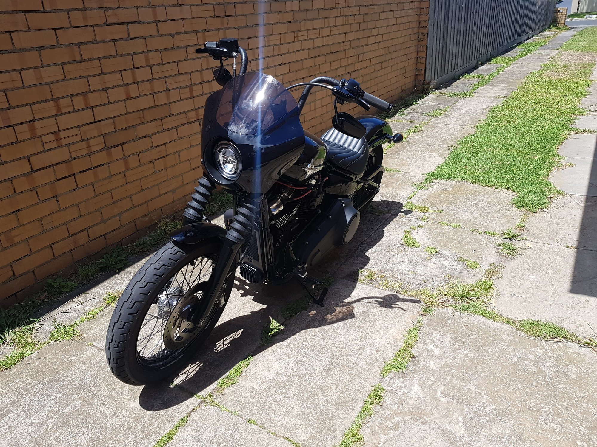

I got one off a Street 500 and fitted it up, was fairly straight forward.

How did you fit it up, any tips?

I had to flip the headlight bracket 180 degrees and drill a hole for the rollpin (you will understand what I mean when you remove the bracket) I used the Street 500 lower bracket and fabricated a top bracket that bolted onto the underside of the top triple tree. The way I did it wasn't ideal because it was secured by the riser bolts, better off trying to get some quick connect mounts.
I've actually gotten a new fairing since then and it came with 49mm fork clamps.
