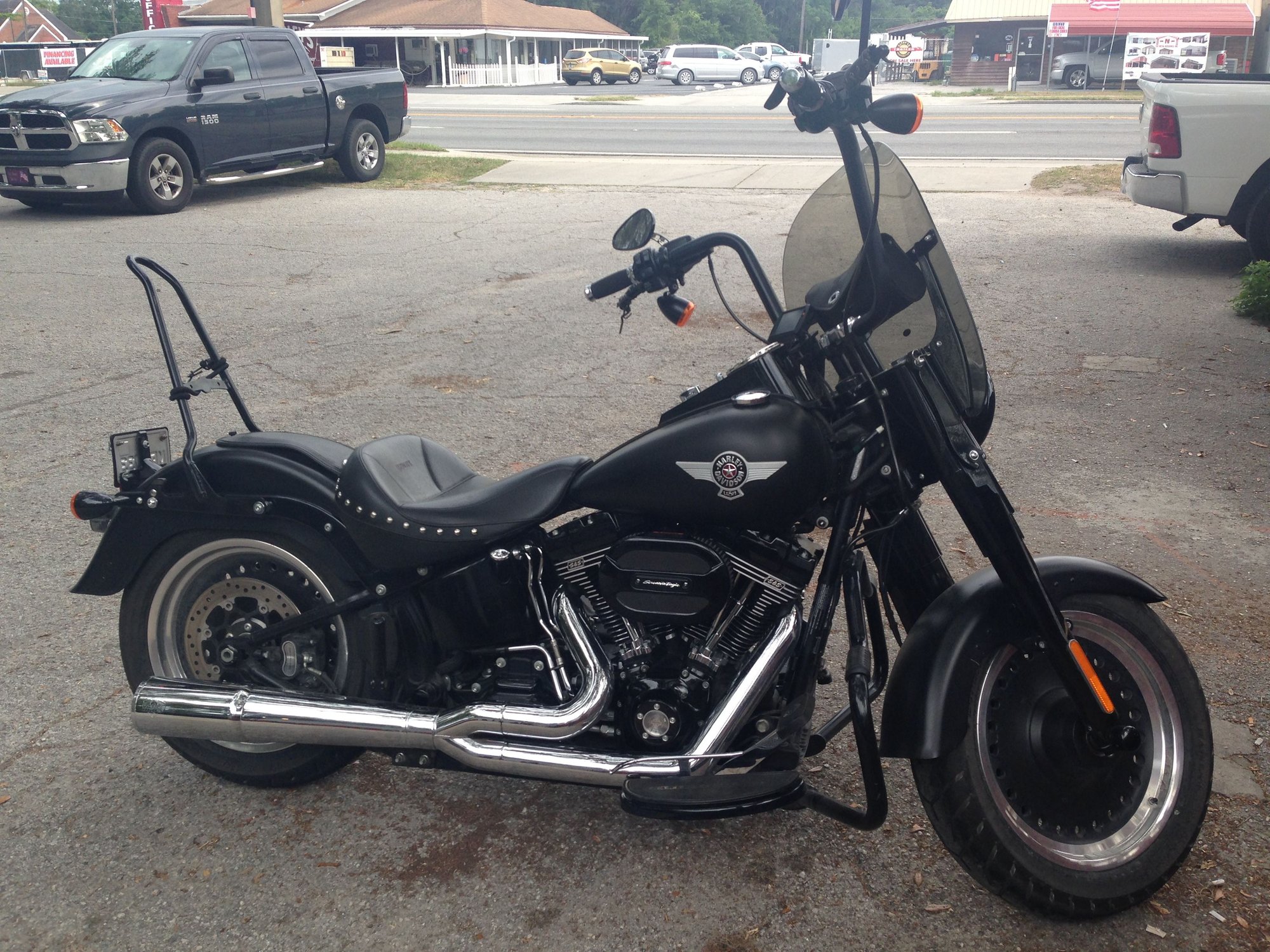

The motor is a Screaming Eagle 110. First chart was with just a stage one, Vance and Hines Pro Pipe 2-into-1, the standard high-flow air intake that comes with the S models, and a Power Vision tune.
Second chart was after new S&S heads, lifters, adjustable pushrods and their 585 cam. I'm happy with the power gain, but still, it seems like there should have been a little more ooomph.

Agreed. I had done only the cam, lifters, pushrods and tune. That's what the first chart reflects. But then the engine broke down about a week after that was done. Bent valve.
Weak valve springs on the Screamin Eagle heads are a known defect.
Make a long story short, Speed's Performance Plus, which did the work, threw in new S&S heads for free, and did a new tune. That's what the second chart reflects.
