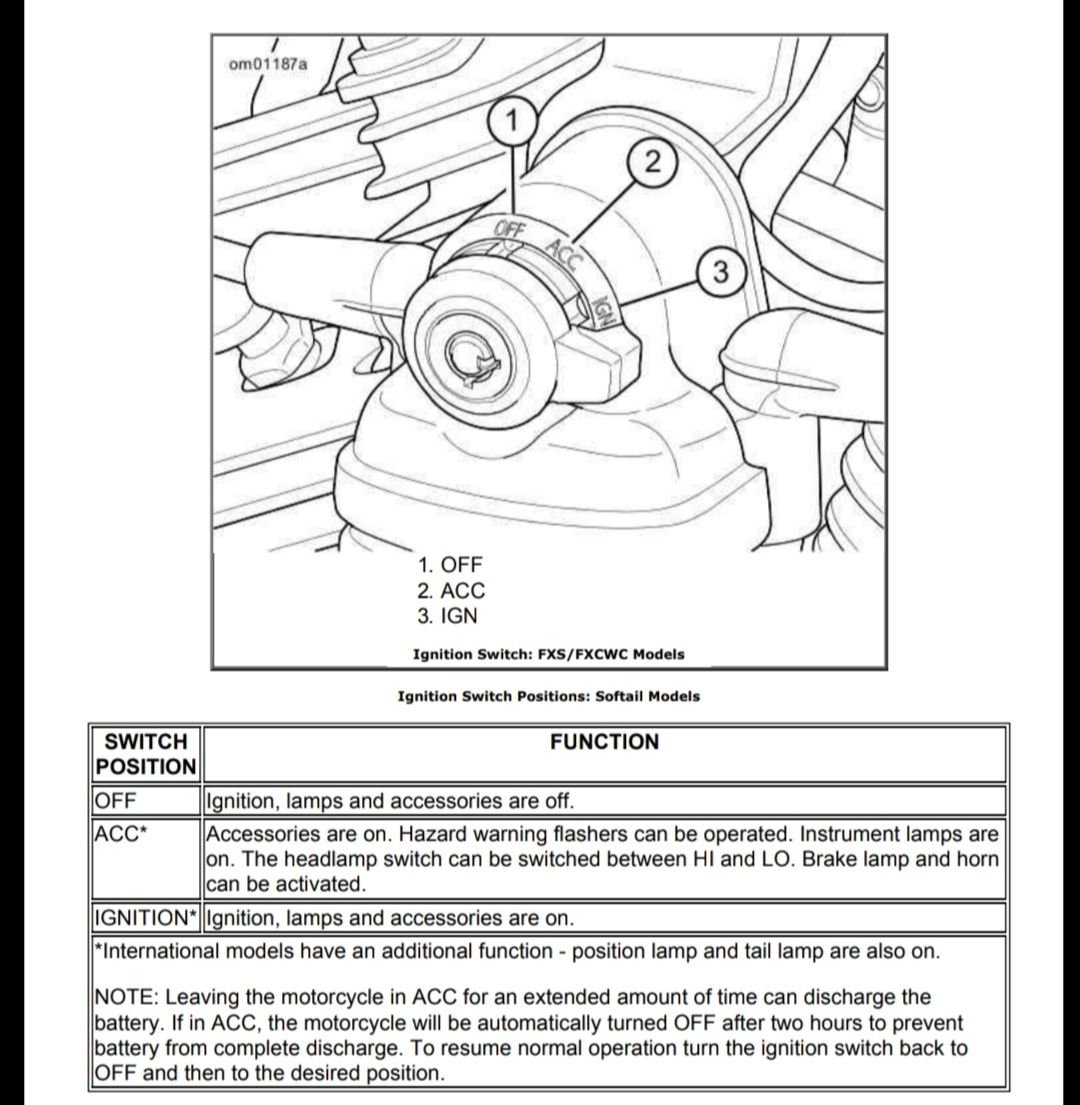

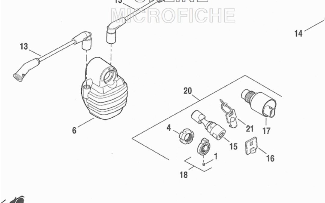

This photo may help. I want to get item 17, 18 & 4. what do you think guys??
Hi every one, ignition switch was failed on my harley rocker fxcw 2009. Im thinking to replace and upgrade it with FXCWC ROCKER 2011. On 2011 the switch came with a **** (thumb lever) which is used to off/acc/ign the switch position with keeping the key a way from the ignition.
Have any one here did similar change? is it possible to do that? what parts do I need to get more than the switch, **** lever and a nut?

I looked in to this as well, but there are some problems with that key set up, the litte lever (18) tends to fall of apparently on the break outs it was installed on

Thanks for reply, to fix the small secrew you can use threadlocker (loctite) which is not used by harley. this is miner issue. is there any technical problem?

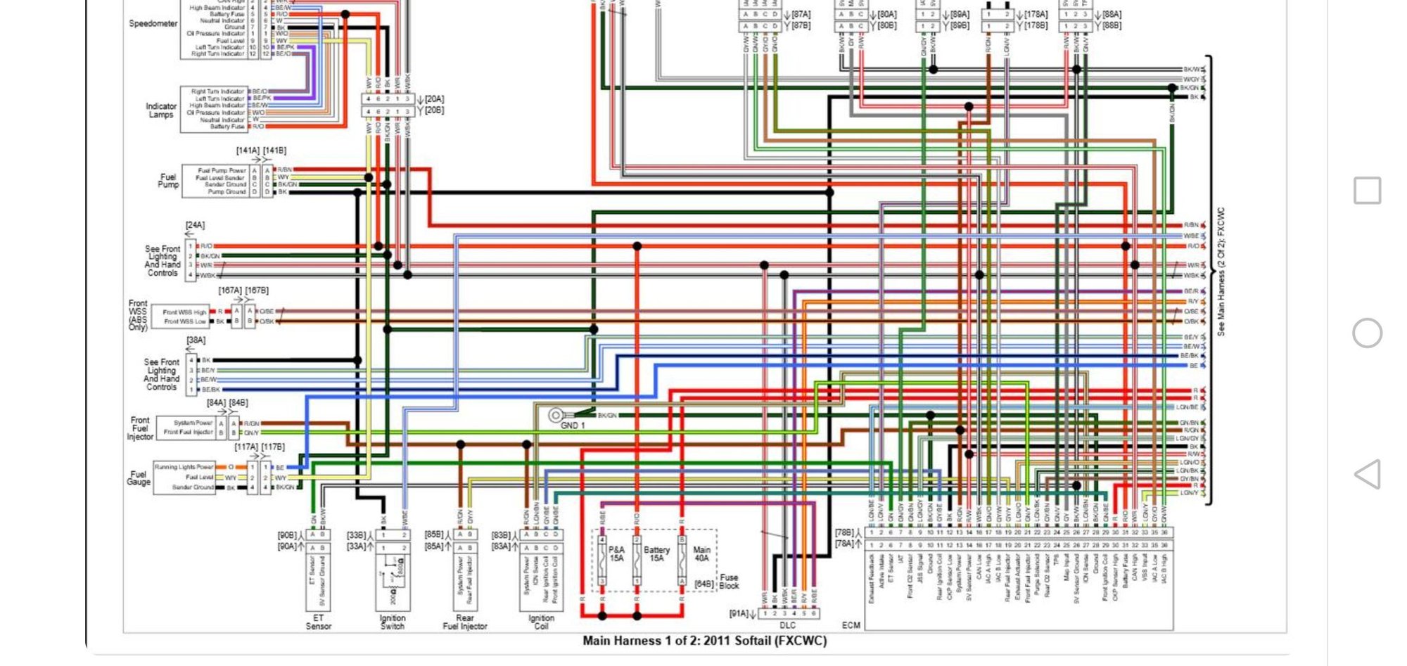

any help would be appreciated. The ignition coil is similar but the switch of FXCW 2009 has 3 wires while FXCWC 2011 has 2 wires only. any idea guys...
need to change FXCW 2009 ignition switch.
to this type of FXCWC 2011 ignition switch

this is 2011 FXCWC ignition switch which has 2 pins connected to 2-way socket.
here is the fxcw 2009 ignition switch which has 3 wires connect to 4-way connector.

That could be just the key switch, where is the accessory rotating switch located on that first diagram?
that's only what I can see on the drawing. I will upload the 2/2 of same drawing.

Thanks for reply. I will work on it and hopefully it become true. Im thinking to use 2-way into 4-way adapter but nut sure if its work. Are the 2 wire in your 2011 one is power from battery and other one is ground? on the drawing one is BK and other is WBE. Can you share a photo?
