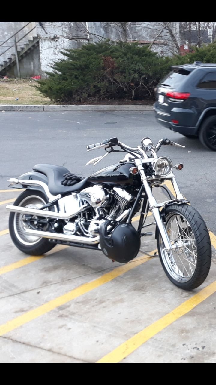

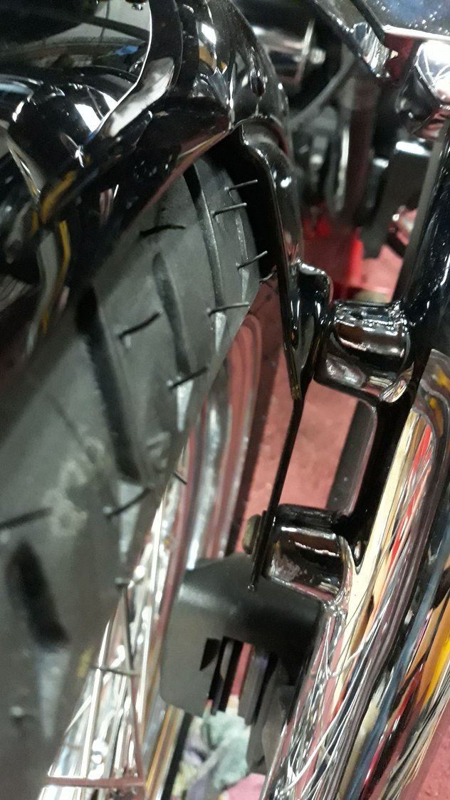

I laced and trued a 21x3.25 wheel up to the stock hub and mounted a 120/70-21 Dunlop Elite. It definitely looks better that the 80/90x21. The new tire does clear the fender. Haven't ridden on it yet.
One note... if you are mounting the 21x3.25 rim from Jireh to the stock hub, you will need 9 1/8" spokes. The stock 9 5/8" spokes are too long.
Here's a before and after....

nice, how about some pics of the front end from further back
