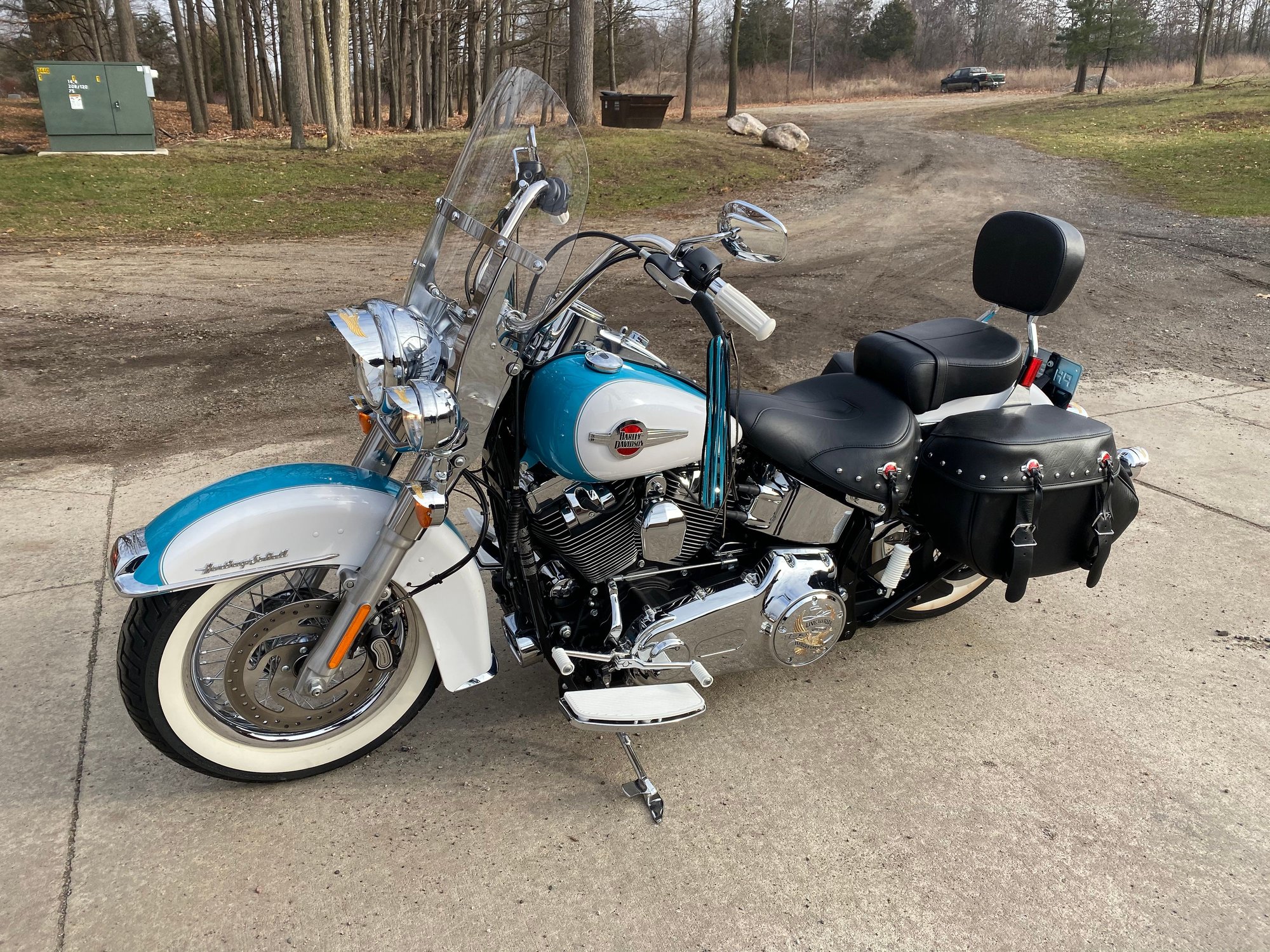

Wife bought a heritage right before the snow hit. 2016 with 146 miles on it. Barely broken in. Since I’m the only one with cold weather gear, I got to ride it the 50 miles home. Noticed some problems getting it into neutral. The usual tricks helped at a stop. But happens far more than I ever experience on my breakout or road glide. She had the same problem on her 12 deluxe, but I presumed it was more experience than her bike.
knowing this is an issue now, I predict this will be her biggest annoyance. Any suggestions to make that neutral easier? Probably going to change the oil and will likely go with redline. Never had this problem on my bikes. So looking for other suggestions.
pics because it’s a sweet ride.

No advice from me, but her biggest annoyance is going to be keeping those White Footboards and Grips White.....
Mike
NY
Mike
NY
that is the effing truth. thankfully the original owner spent all that money.
