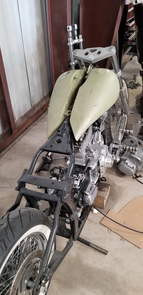

I have an older Fatboy frame and I am putting a Twin Cam 88 in it. I want to convert it to carb. Most posts I see or find tell you how to do it with the EFI harness. I don't have that. I need to know what ignition to use, does that ignition have a harness? Do I hook it up to a crank position sensor? Do I need to make anything? Changed the side casing to an older carb model? I understand the carb and the manifold, just dont know about the electrical. I also will not have the turn signal module crap.

I removed the EFI and installed a Mikuni carb on my 06 Deluxe. I installed a Thunderheart stand alone ignition and used most of the OEM wiring so I am of little help.Try posting the same questions over at https://www.chopcult.com/default.php they will help you.
