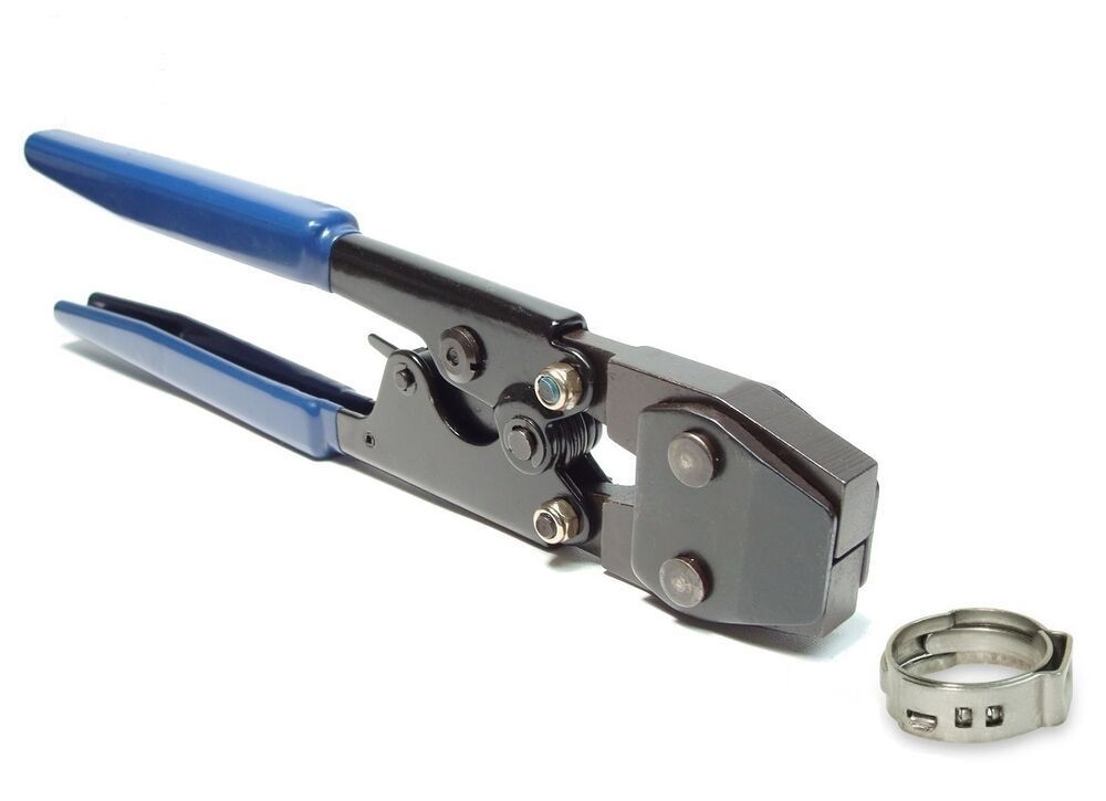

Getting ready to change the fuel filter on my 06 Deluxe EFI. Can someone advise what tool is used for the crimp type clamps? I've looked everywhere and can't find one.

Something like this will do the job , head down to your local hardware store , if they sell plumbing or irrigation , they should have the pliers . Maybe not as elaborate as these , but they'll work just the same .

Thanks for the information, When doing a search for a "crimping tool, is far different from a "cinch tool" LOL The correct name made all the difference Thanks again
