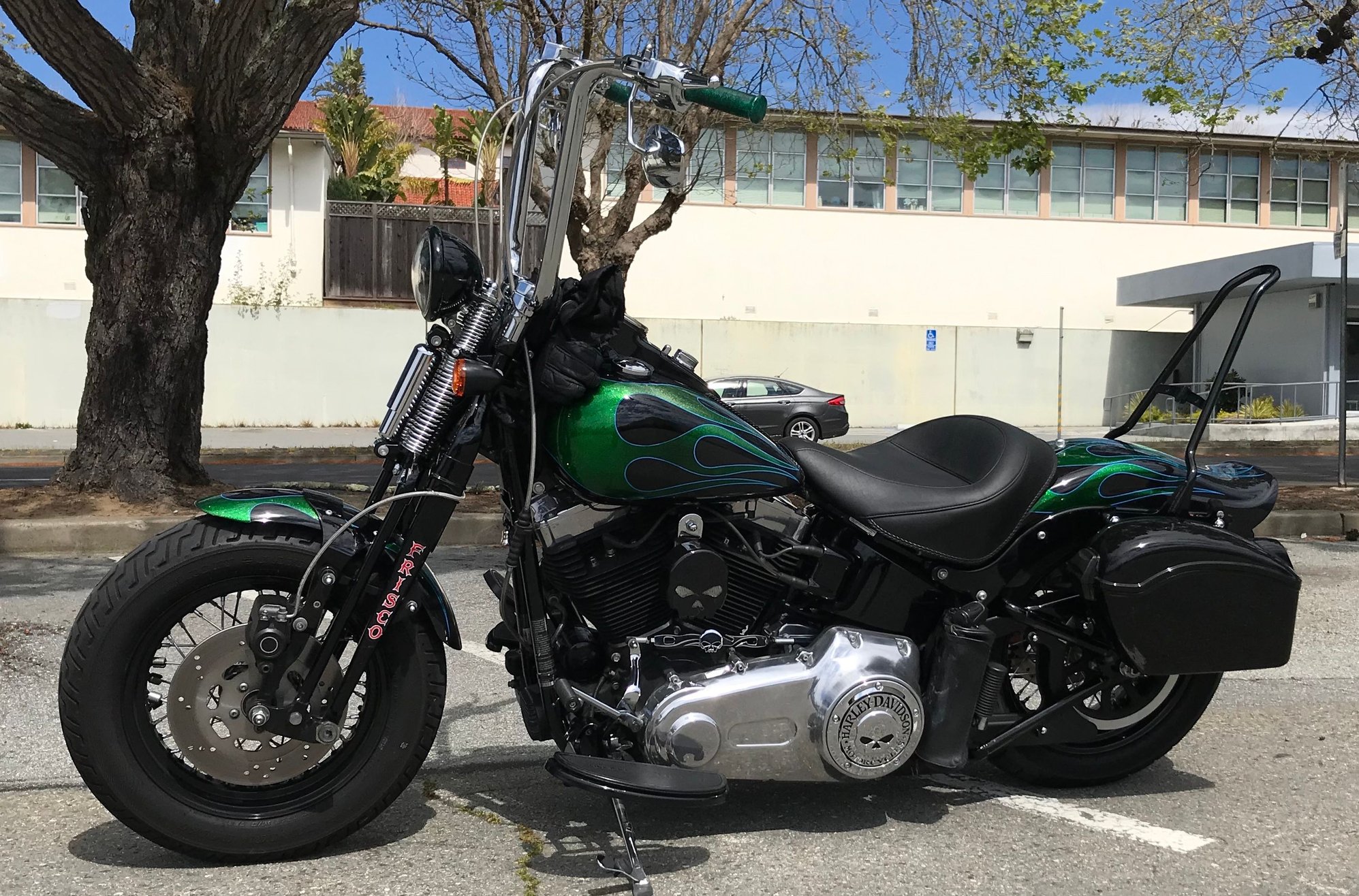

These are 14in. with 3 1/2 in. risers , needed to get longer front brake cable and reroute my clutch cable .

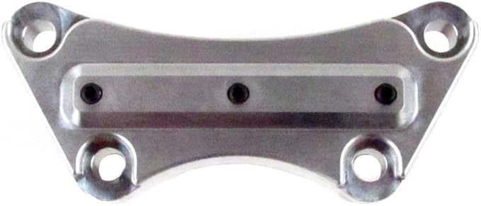

I found with the 14" the leverage was to much with the stock clamp and the bars could rotate so I had to install a clamp with set screws for apes.
Like this.
Like this.
My bars have indents in the clamping area and that's been just fine so far. I've pinned tall apes in the past and if these start slipping I'll do the same.
I didn't want to pin because I did internal wiring and incase I needed to roll the bars back.
