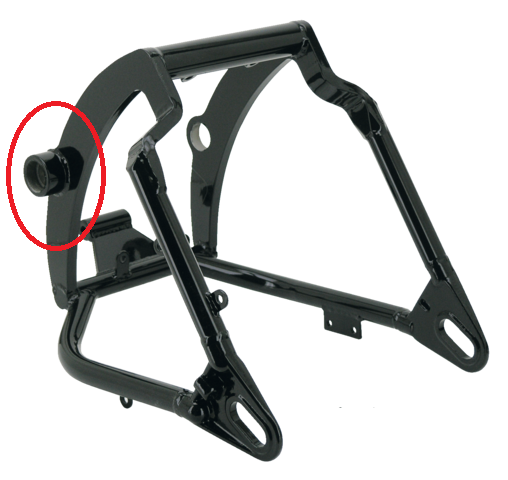

if the swingarm doesn't have an offset like this...you will never get the chain/belt over far enough to clear a 250 tire...
