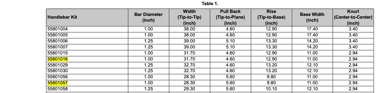

Im just looking for some help with an answer if these bars will fit on my 2018 FXBB Street bob.
I have downloaded the HANDLEBAR INSTALLATION REQUIREMENTS 2020-03-16 PDF.
It says 1" FUSED HANDLEBAR TALL 55801016 will fit with all the parts required to fit.
It does not list the 1" FUSED HANDLEBAR LO as fitting.
Im confused as the only differences I can see in the bars are
LO has 1" more pullback than the HI
LO has 3.1" less rise than the high
LO is 3.4" narrower in the width tip to tip
They both are 1" bars so will fit the top clamp and the base with and knurl are the same.
They both have the E throttle cut out in the picture
I can't see any reason why they won't fit can anyone confirm this?
