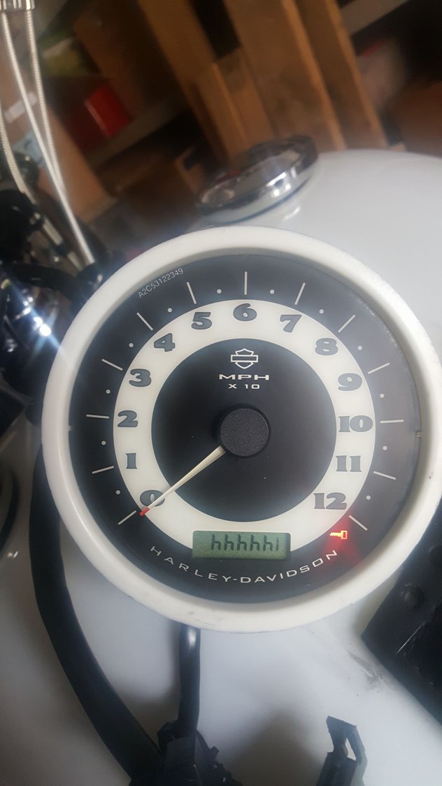

I have a 2007 HD Softail Deluxe and noticed that the odometer is not working . The speedometer, turn signals work and no issues stalling. When the bike is turned on the following code is viewed from the odometer window "No LHL" and the after 10 seconds or so it goes "hhhhh". Any ideas? Odometer bad? Can the odometer be sent to a repair facility? Or new unit in my future. Thanks.

Codes loop from "No LHL" and after 10 seconds or so it goes "hhhhh", I think the odometer is bad.

I would try unplugging it and replugging it just in case a pin connector has corrosion. Be sure to eyeball connector and pins. Run back down the line for damage. Piggyback stuff should be temporarily removed if you have it and if possible. Are you saying it's reading hhhhh or making a noise? Do the youtube how to diagnostic error codes and check. Be sure it flashes SP for the speedometer.
The first will be PPSPT. You press and release reset to go from P (ECM) S (TSM/TSSM) SP (Speedometer) T (Tac)

To be clear, I removed the speedometer from the bezel, checked the wiring it looks good placed contact spray in connectors, removed the main fuse waited about 15 minutes when I reinserted the main fuse the LED odometer reads the following "No LHL" and after about 10 seconds or so it goes to "hhhhh". If I depress the trip button nothing happens.

Guess it's telling you what is wrong but I can't find LHL. What does it do if you put key to accessories side and hold button?

Check your Low Head Light

Low head light? Will do.
