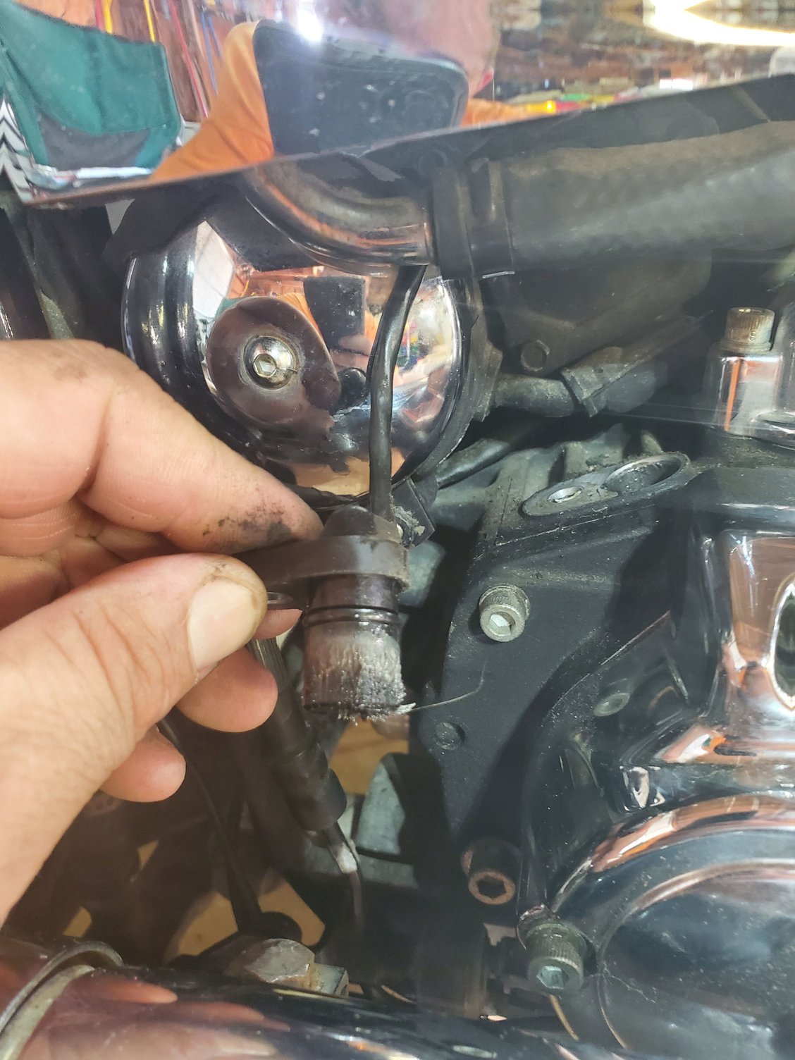

Old Jun 2, 2020 | 06:43 PM
miafcowboy's Avatar
miafcowboy
Joined: May 2020
Posts: 17
From: MI
Default Update
pulled sensor. Cleaned it off. Reinstalled, and test rode..... no glory. Ill be getting a new sensor tomorrow from harley. Ill update after i switch it out. THANK YOU EVERYONE

Thank you everyone. Ordered a new one from Amazon, didn't fit ugh. Called local shop and they had one, installed and now I have speedometer AND odometer. Works as it should put 100 miles yesterday. Saddly, pretty sure the cam tensioners let loose when I got home.... new research commencing
Old Jun 14, 2020 | 08:46 AM
Flstcjay's Avatar
Flstcjay
Joined: Apr 2018
Posts: 280
Likes: 103
From: Manitoba
Dude, not trying to be negative but that is a lot of debris on the speed sensor and should indicate that that bike needs a solid look through before riding. Not sure what you mean by cam tensioners “let go” when you got home, cuz that’s not how that works. They wear down and throw metal debris all over the place.
