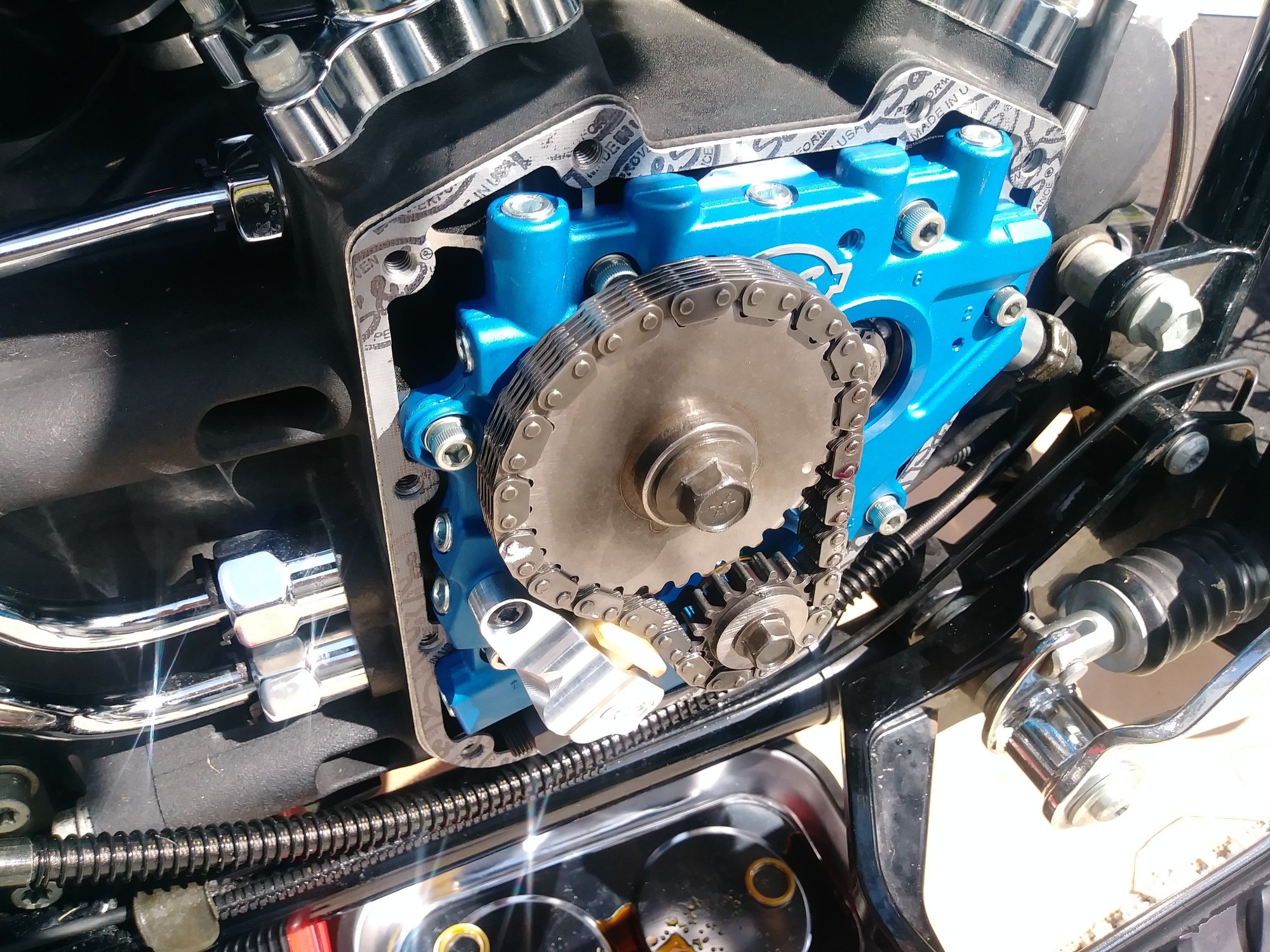

This pic shows the cam tensioner.. I put a red arrow pointing to the orange tensioner pad that rides on the chain and gets worn and/or can disintegrate prematurely. There are two tensioners. The one you see in this pic, and one on the back side of the plate riding on the chain between the cams..
This is my 2003 Heritage when I opened up the cam chest to fix them...

I went with the newer '07+ camplate/oil pump design, with conversion cams, HD hydraulic tensioners, and the better o-ring chains instead of the older link chains...
[/url]
There are several different ways to handle a spring tensioner upgrade... from $$ to $$$$$... all with pros & cons...
