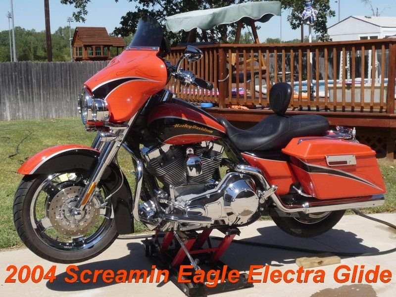

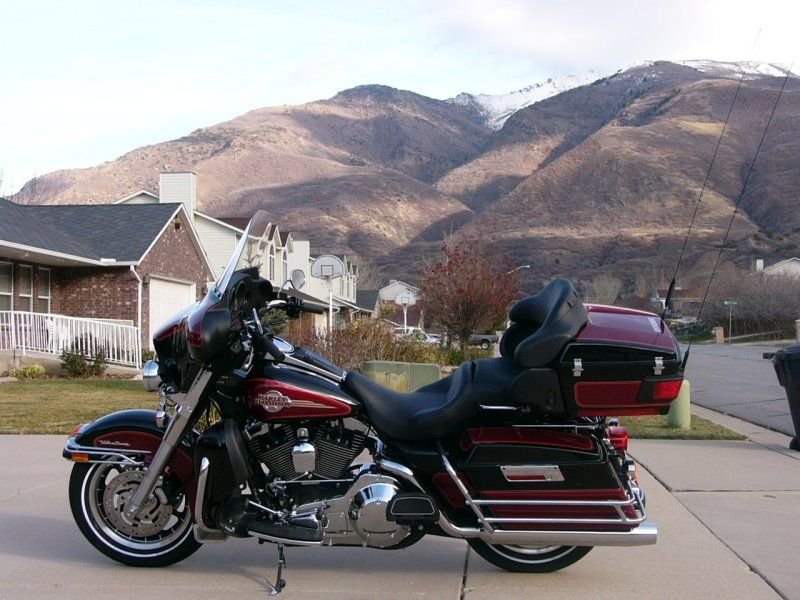

My first Harley was a 2005 Ultra that I bought new. I was doing a lot of long distance riding and had almost 40K on her in two years. When the 2007 models came out I got the bug for the bigger motor and the six speed, and bought an Electra GLide Classic (big mistake). Never really liked that bike. It always felt like it was in the wrong gear, it ran hot, pinged, all that. Harley had some details to get sorted out like the cush drive hub. After a couple of years with that one I decided to go back to a five speed bike and found my dream bike, a 2004 Scremin Eagle Electra Glide. That bike was great, loads of power, looked great, and I loved it. Then in 2013 I had to give up riding due to back pain and surgeries.
I had focused on fishing and kind of given up on riding until recently when my BIL passed away. I bought his Electra Glide from my sister, but it's just too heavy and hard to manage. I'd always wanted a heritage and found out a guy right down the road had a 2009 heritage for sale, 17K miles and looks like a new one. And these days I can financially swing having a toy that I don't use all the time.
The red/black bike is the 2005, the black on is the 2007, and the orange one is the 2004 Screamin Eagle
