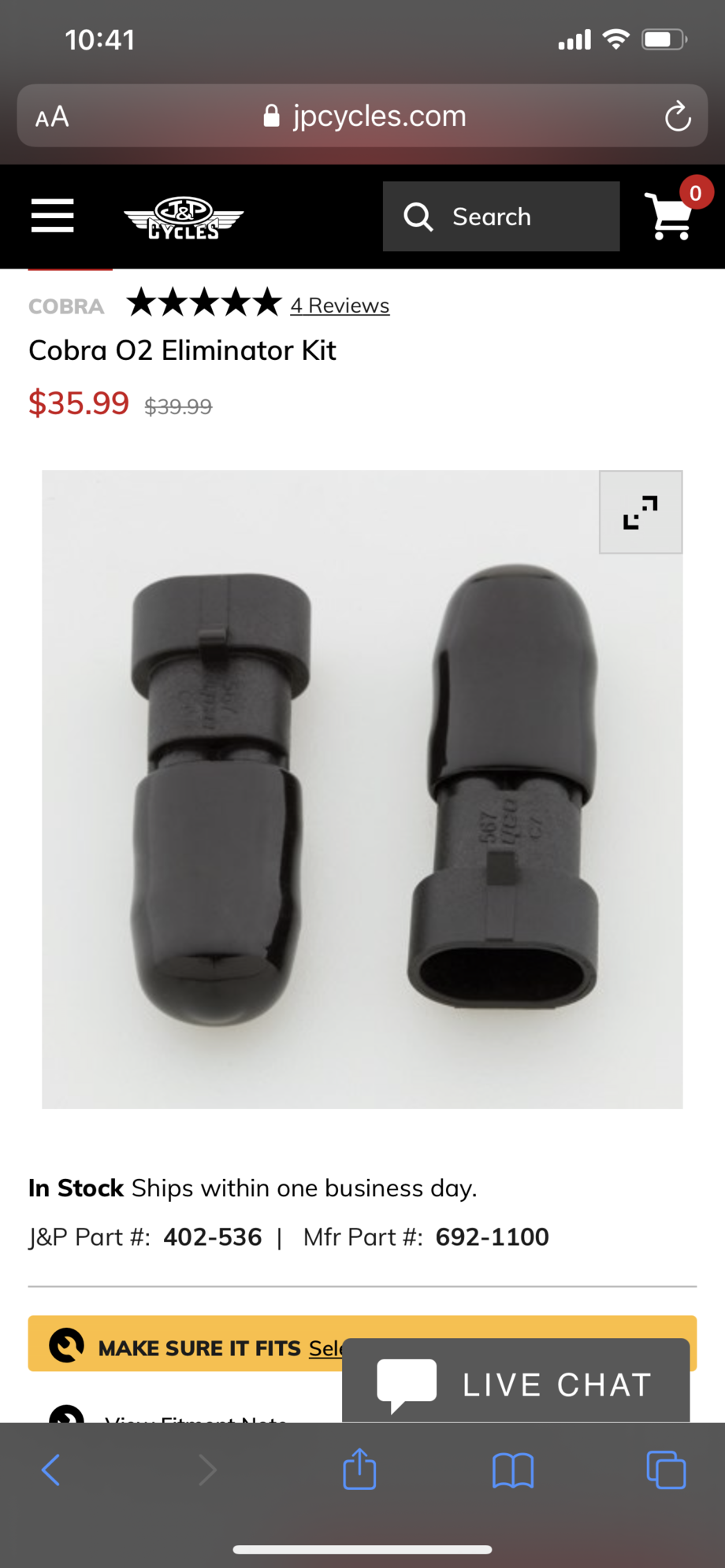

Old Jul 17, 2021 | 12:56 PM
hattitude's Avatar
hattitude
Posts: 14,064
Likes: 11,081
From: San Diego, CA
Originally Posted by Kinamyen
It came with O2s. I found the harnesses. So I think I am going to see what it will take to add them back. Either welding bungs to these pipes or getting a new exhaust. Not sure what I would have to do to the EFI if anything.
If your bike has been running fine without them, and you have no check engine light, it strongly suggests that you have them turned off in the ECM, and an all open loop tune..
If that is true....
Once you add the harnesses and the O2 sensors, they will do nothing until you (or a shop you hire) uses a tuner to turn the O2 sensors back on in the ECM, and then flashes a proper tune (part open loop and part closed loop) for them to work, and have any affect on the bike's performance...
Old Jul 18, 2021 | 10:02 AM
Kinamyen's Avatar
Kinamyen
Joined: Dec 2020
Posts: 29
Likes: 16
From: Columbia SC
These are currently on the end of the O2 wires.
