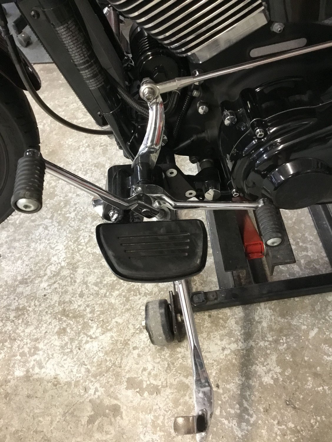

But I like heel/toe shifters and put one on my 2001 FXSTS Springer.
I did as you are thinking of doing. I went to Ronnie's parts fiche, and looked up the parts for a same year softail, with a heal/toe shifter and bought the parts needed to make the conversion... I used all HD parts figuring it would be more apt to fit properly
I had to buy a different shift lever assembly. Plus the shifters were different between the heel/toe and the just toe shifter, so I also had to buy two shifters, two pegs, and a bushing... I had already added 5" foot pegs because I wanted a little more room for my feet... With a heel/toe shifter I suspect it would be almost a necessity...
Here is my parts list, from my service logbook... Again, this isn't for your bike, it's just to give you an idea of what's involved...This was for a 2001 FXSTS single shift to heel/toe shift, on a twin cam softail frame..
Here is a pic of the finished product..

Based on back again's post above, I checked the Ronnie's site and it shows the same lever assembly (#33668-90C), same shifter levers (#33895-82E), and same pegs (#34611-79), as well as the o-rings and washer that I used, fit a '91 softail Heritage with heel/toe shifter.. that makes sense since the suffix on the old part numbers normally meant the first year they were used, and those suffixes are 90, 82, & 79.... the part numbers I used, should fit a '91 bike...
Whether you go new or used.... double check for yourself before making a purchase.....
Good luck with your mod...
