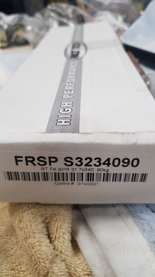

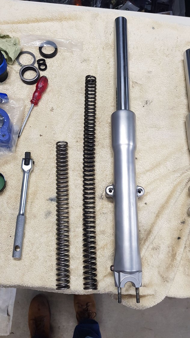

Anyone installed a set of racetech fork springs on an early twin cam fatboy?
I've double checked the part number and it's correct according to racetech website.... but they are seriously shorter than the factory springs? It comes with some PVC piping to use for spacers, but looking at my springs, I'm going to need 230mm spacers to make these work? That can't be right.
Bike is an '02 fatty.
Any advice appreciated. I have contacted racetech, but no response yet.

Originally Posted by kel03
Looks like someone put the wrong springs in the package.......
Yes, that's what I thought. But the spring length is actually written on the box below the part numbers... and it matches up?

I'm thinking of making the spacer just long enough so that the new spring and spacer equals the same length as the old stock spring??

i didnt do racetech.. think i did burley
but mine had that spring and small helper spring 2 washers and pvc spacers
seems to me that is missing some stuff, i know there different for every bike but mines a 98 fatty
and the kit i used was easy.
it went
long spring, helper, washer, pvc, washer then top nut
think i cut my pvc down to a inch and a 1/4
