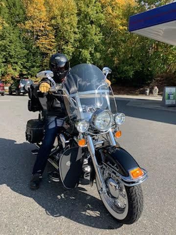

I hate to be the guy to say lower your bars, lol. I have a Heritage, I did 14's and they put my hands a click below my shoulders, I'm not at as tall as you, but I can tell you I have all day comfort, I've ridden up to 9 and 10 hour days on mine, all back roads so I'm not hanging on like I would be at highway speeds, but they are perfect, for me anyway. I'm not one for the throttle lock on the throttle side, but I did use it coming across Rt 11 in upstate NY, it was a long straight shot for miles, most of the time I sat back and relaxed. But it does work well, just use it with extreme caution.

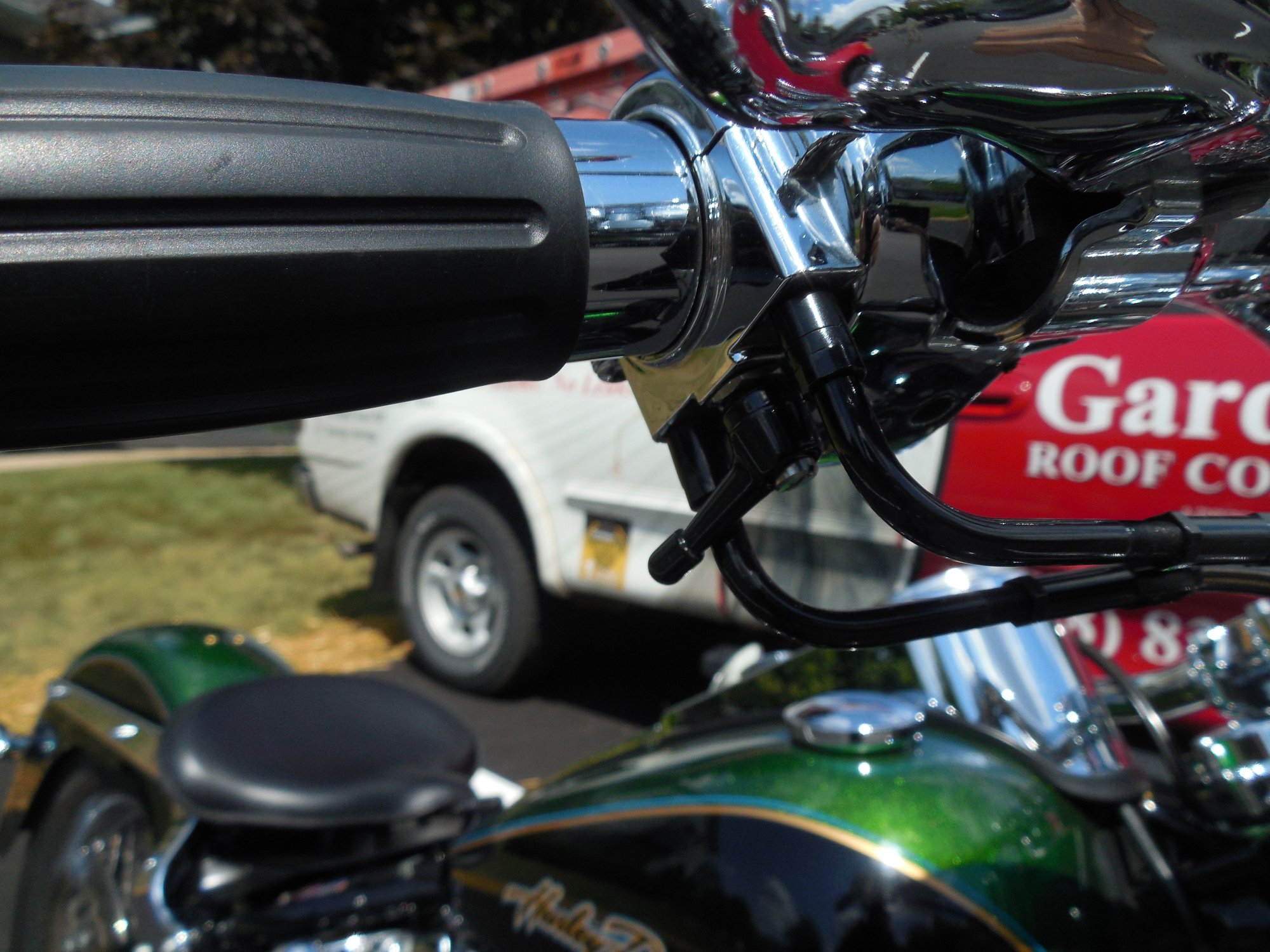

Here is what I use and it works great.
https://mycruisemate.com/index.html

That's awesome, how was the install? I looked it up, seems like that have some tap kit for $10?
