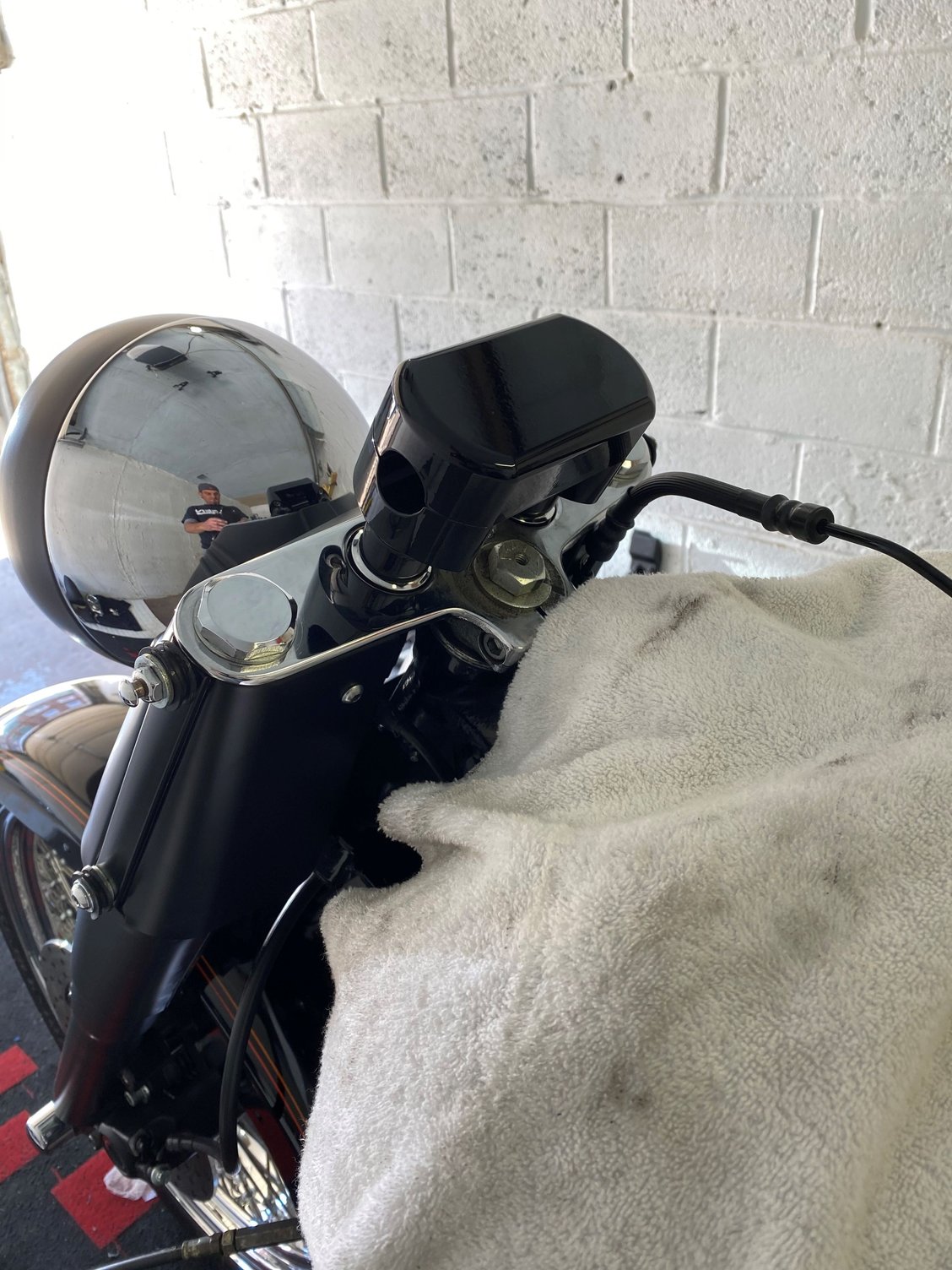

Here is a pic of the bar install on my '16 bagger. I replaced my OEM 1" bars with 1 1/4" bars. I have arrows at the step downs for the clamps and the switch packs..
