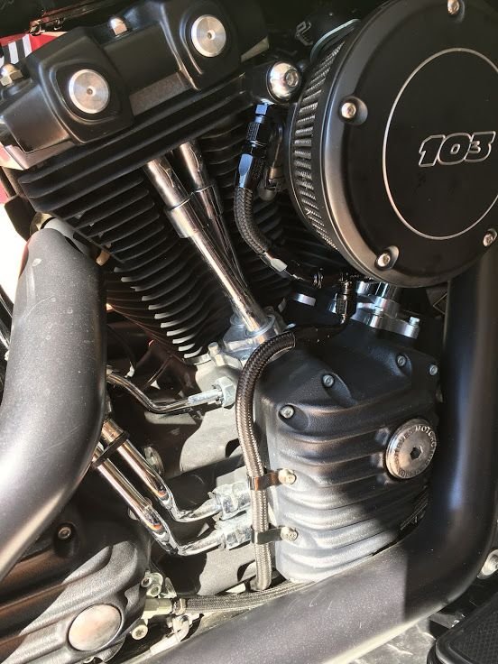

Does anyone have pictures of an oil catch can installation? I am wanting to add one to my 2007 Fatboy as opposed to venting it out the bottom of the bike, specifically the DK Customs Catch Can.
I currently have a Screamin Eagle Heavy Breather installed and I know there are some challenges with trying to run external vent lines but I am working on that.
Thank you in advance.

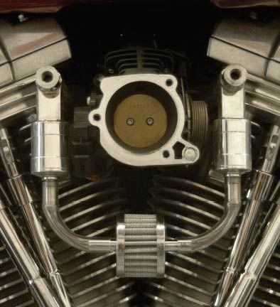

Lots of information from guys that run catch cans like DK, DIY setups, etc, with pictures in the Twin Cam Motors and Engine Mechanical section; lots of help there. I attached a photo of the setup I ran before installing the SE heavy breather on my 98" motor. Crank vents routed to a small pleated filter. Ran the same setup with the heavy breather but had to make modifications for for fitment. Also changed the clear lines to black rubber fuel line and the filter to an enclosed cannister filled with fiber mesh to catch the droplets. Shouldn't need more than this if good ring seal and internal breathers working properly.

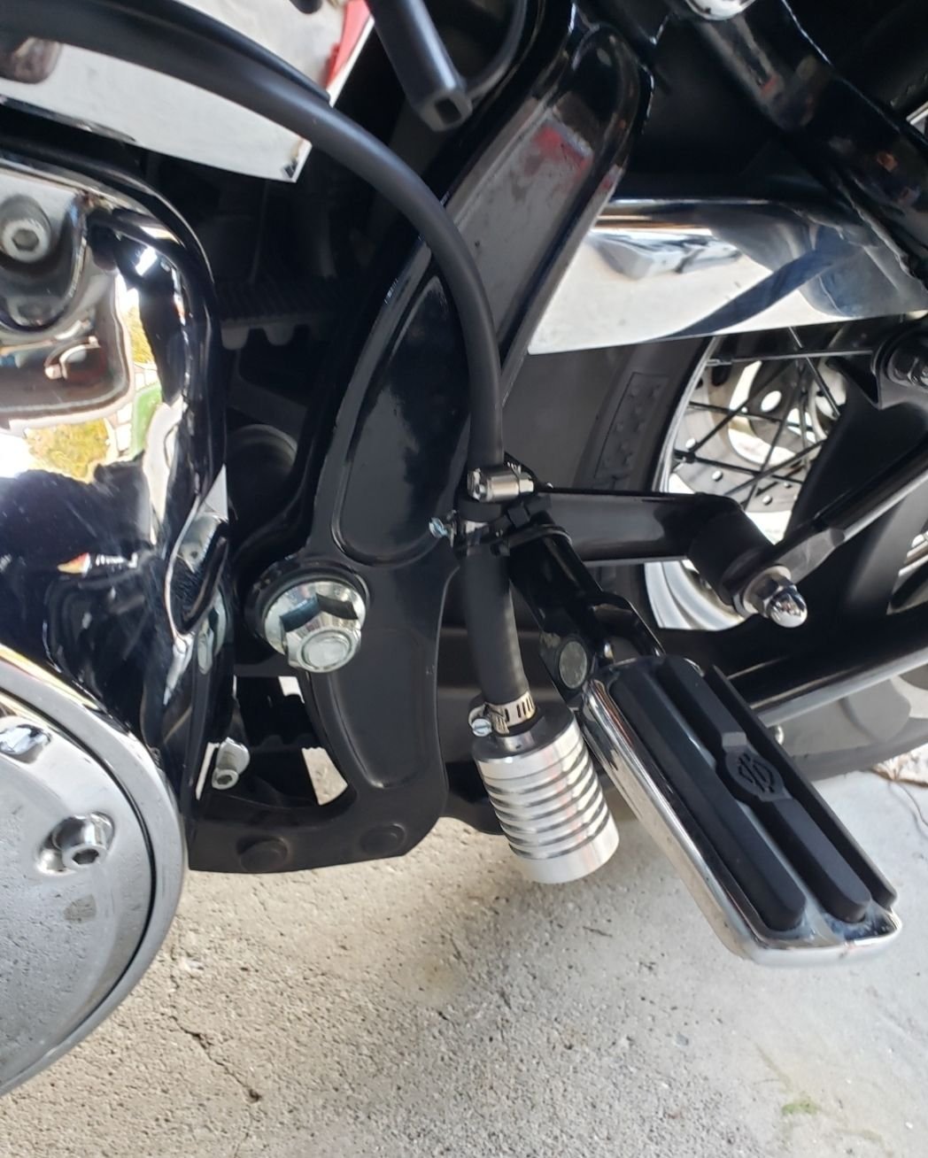

I snaked mine over to the lefthand side and mounted it by the passenger peg.
