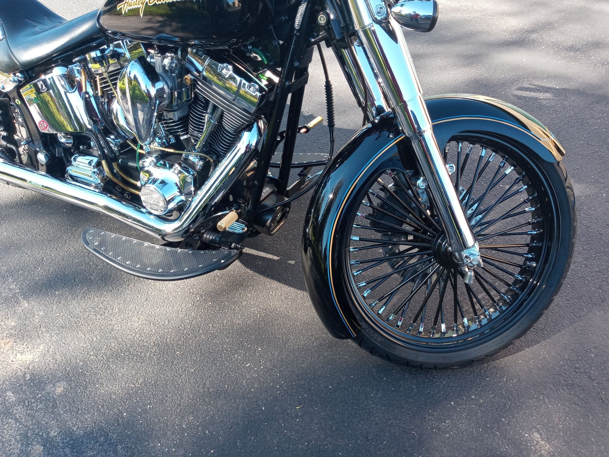

Getcha a set of chrome lowers that fit your bike. Here is mine on a 06 Deluxe same setup that you need.
