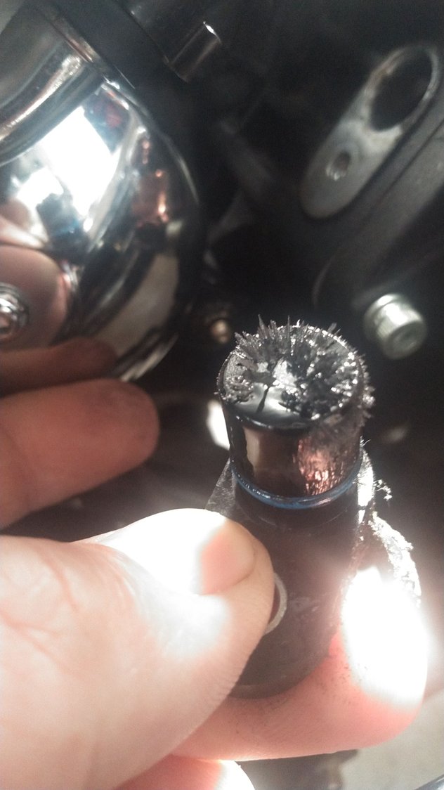

Hattitide, thank you for your response. No, my turn signals do not cancel on their own. This speed sensor, is this it? See pic below.
That's it....!!!
Well, that's the easy end to get to....

Hattitide, thank you very much for the information. I pulled the speed sensor off and it did in fact have quite a bit of metal shavings on it so I cleaned it off really well and then reinstalled it. I took the bike around the block to see if that worked and unfortunately it did not. Speedo mph gauge still isn't working and the turn signals aren't turning off on their own. I guess I'm gonna have to do some research and see how to test the sensor to see if it's bad and then go from there. Wish me luck, and thanks again for your help man. I really appreciate it.
Good job.... I actually saw one speed sensor that easily had twice the filings you have. But his signals self cancelled and his speedo worked, but was erratic.. He cleaned his and all was well... I believe that was 3-4 years ago, on a 2006, and it's still working as far as I know....
If both your speedo isn't working, AND the turn signals are not self cancelling, after cleaning that plug, that's a pretty good indicator that the speed sensor is bad.... but I hate to just throw parts at a problem without a solid diagnosis... Sorry I can't remember the test for it, but it should be in the electrical diagnostic manual, or it's probably on youtube or somewhere on the web...
