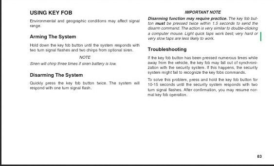

2003 didn't have a proximity fob. The system is armed/disarmed by using the button on the fob.
Do you have the owner's manual? The procedure for modifying the existing PIN is in there.

As barneyboy pointed out, the OEM TSSM (security module) for the 2003 model years does not have a proximity alarm (passive system). It is an active system, it needs to be turned on and off with the FOB.
The wild card in all of this is the highlighted portion of your post... this "bluetooth keyless ignition" that the previous owner installed...
Is it just a replacement of the actual ignition switch...??? Or did it also somehow replace the TSSM also...???
I am unaware of an HD product that retrofits into the TSSM bikes, that changes it to the '07 HFSS security system, or the 2011+ "BCM style" of security, where it is a passive system.... but that doesn't mean it does not exist...
You could try to see if the alarm activates and deactivates per the instructions posted by barneyboy. If that works, then you know the TSSM (security system) is of the OEM 2003 variety, and that is probably the OEM key fob...
If that doesn't work, you need to figure out what has been installed, and get an owner's manual for it, to know for sure what is going on..

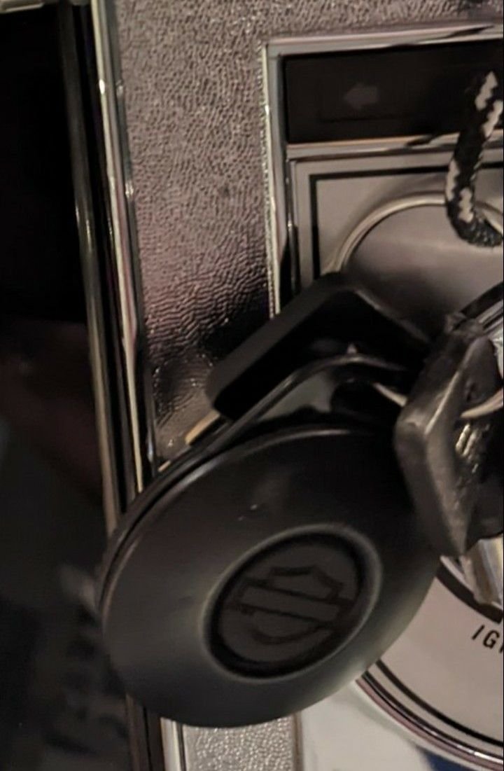

I could be wrong, but I think the OP may be mistaking the OE fob for a Bluetooth device. The OP posted the image below in another thread.
Yes, I posted this picture about something else. That is the fob I have. I don't know if it's original equipment, I assumed its not because the bike has a keyless ignition.
I assumed it was aftermarket Bluetooth. The previous owner upgraded so many other things, I assumed Bluetooth ignition was one of them.

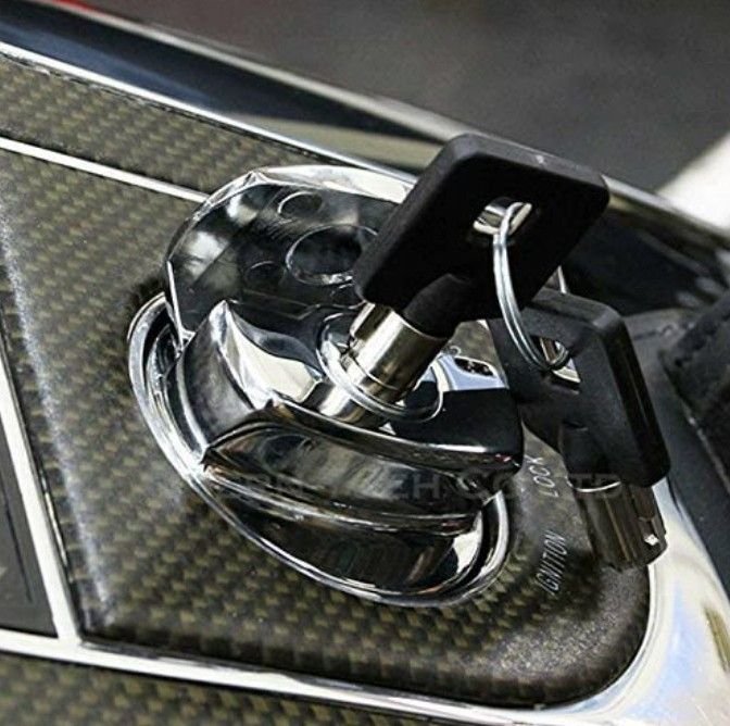

Can you post a pic of your ignition switch? The OE switch has a hinged cover that hides the keyed lock.
While pushing the key in, you can rotate it clockwise to the unlocked position, and remove the key. Then you can close the cover, and rotate the switch without a key. The switch will remain unlocked until you reverse the procedure.
