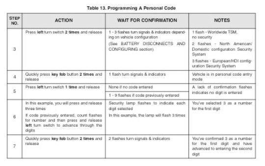

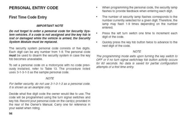

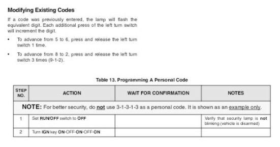

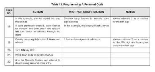

Below is the complete procedure from the 2003 owner's manual. This procedure makes no mention of the odometer window. Instead, feedback is provided by the number of flashes from the security lamp. (Note that 3-1-3-1-3 is used as an example). It may take several attempts before you get the hang of it, but it will work if done correctly.
Sorry for the lousy images, working from my phone.
