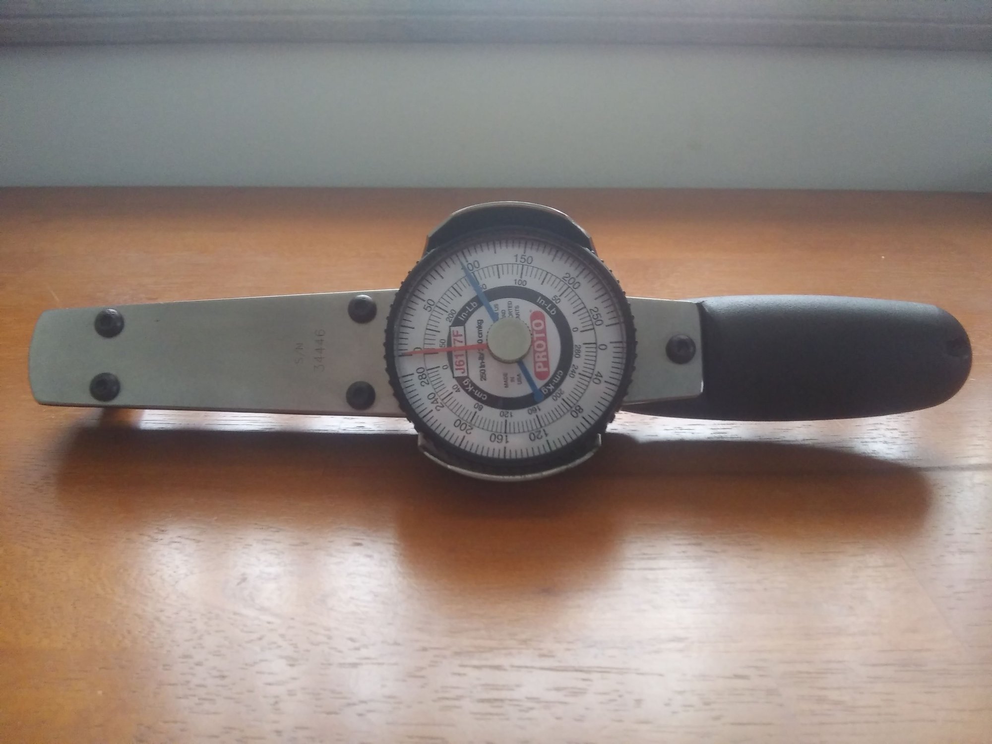

I've torqued hundreds of those screws to 95 in-lbs, and I've yet to strip a primary cover or screw. That being said, I've always used a fairly expesive Proto torque wrench with a dial indicator. Total range is 0-250 in-lbs.
